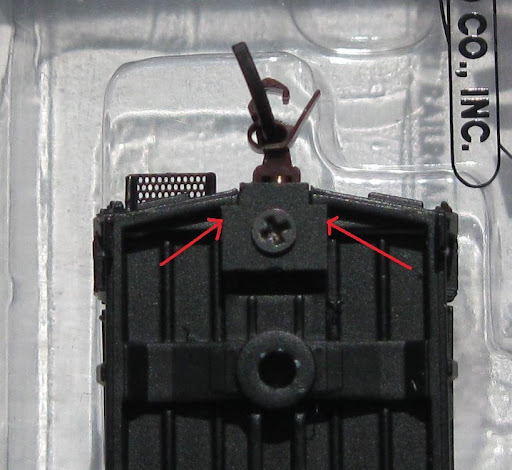

I've been comparing my gon to my BLMA 4000, which tracks quite well. But my BLMA gon keeps derailing on my Unitrak 15" radius test track.
I noticed that the coupler pocket cover plate seems to be wider on the BLMA gon compared to the 4000:
Actually, it may be more about the wide portion sticking out further, thus increasing the possibility of the wheel flanges rubbing on curves.
I may be barking up the wrong tree here, but I'm gonna try removing some of the material on the plate on both sides as indicated by the red arrows here:
I will report back later with the results.
Interesting little side note, the tread on the 33" wheels seems to be a little narrower than on the 36" wheels.
Mark

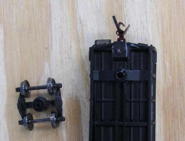

Ok, finally got around to re-sizing the coupler cover plates - like this:
This seems to have solved the problem, as now the car can be pushed/pulled in a three car consist on my 15" and 11" radius test tracks. Not sure how it will do in a train since I don't have any track laid yet.  ::) As soon as I find my NMRA standards thing I will check the gauge on the wheelsets.
If you decide to narrow the coupler cover plates, be SURE not to take too much off, as on one side (the "hidden" side) there is a recessed area designed for the corresponding "pin" on the MTL coupler.
I lined up a underside photo with a piece of Atlas 11" radius track "sitting" on the trucks to illustrate how close the flanges get to the coupler box, but it did not turn out, so will try again to get this photo tomorrow.
Mark
