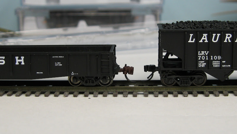

Picked one up in Wabash today. Been sick the last couple days so I hastily took these pics:
Compared to stock MTL gon:
Compared to Bluford body mount:
Compared to ESM body mount:
A couple quick observations -  the model looks really nice! 8) The one I got does not roll very well though, not sure whats up with that and I haven't had time to look into it.
I think that due to the body mounts these will need at least a 12" min. radius (they did not like the 11" radius Kato test track).
I'm not totally happy with the way the couplers stick out, maybe they could have mounted the coupler box a little more towards center (I have not looked underneath to see if there is any reason the mounts could not have been done to reduce the "goose neck" effect).
I posted some comparisons to other recent body mounts for visual comparison.

I got to look at the copies Ed brought to Eric's last night, and I dare say car is a 99% win.  The two issues I saw were the non-functioning drop ends (a reasonable compromise if the result is the lower profile and body mounts) and the extension of the couplers.  That being said, the fact that it's the appropriate body length and a good low rider, the extension is far less noticeable.

Ahh... the coupler.  I knew that'd get a ding... if it was put any further back, there was a possibility of head of the screw holding the lid on interfering with the axle... especially on the A-end.
The drop-ends... I don't know what to say.  They are separate pieces... but since they're made just like a proto drop-end (i.e there's no hinges, just two latches on the sides that hold the end in place on the proto) they'd just fall down all the time.  So glued in place won out (the same was done on the Tangent HO model)...
