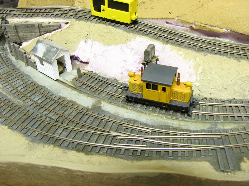

This is Nn3 trackwork:
I used HO scale 2x4's for the filler ties. About every 6th tie is a PC board.
I painted it all, but the paint chips off the PC ties if I'm not careful. I think the same would happen with styrene.
