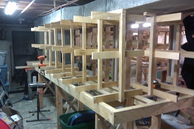

Technically, it wasn't the weekend, but since football was still on, I'll count it. I got the supports up for the last peninsula last night:
All that's left is the front bracing, then we can start with track laying,
Phil
