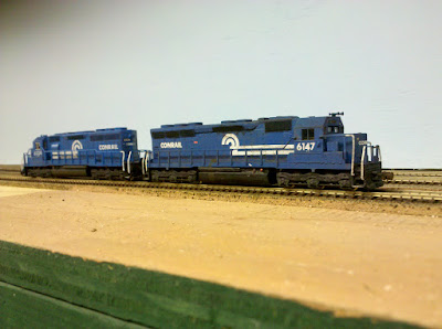

Also, just because they were gone by my year, doesn't mean I don't have one:
