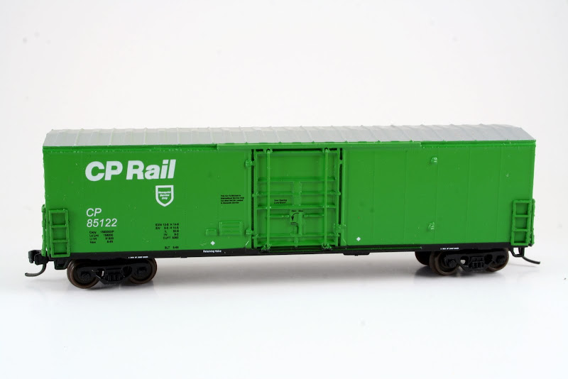

The net effect is to give the car a much lower profile, both in ride height and overall height of the end bulkhead:
I'm always impressed at how much better these centerbeams look when lowered.    Great work, Gary!   8) 8) 8)
With the lowering & body-mount couplers, what kind of curve radii can these cars negotiate?

Hi Ed.  I haven't tested this rigorously, but so far I've had no trouble with the 19" curve on my test track (w/o easements), either alone, or coupled to the short-wheelbase corn syrup car, also w/ body-mounts.  Since I'm still intending a 20" min. w/ easements, I'm happy with that. But I can do a little more testing with smaller radii to stress it -- I'll report back.
Note that the truck side-frames just clear the lower edge of the sidesill (close to prototypical), so that is not really an issue unless you have sharp vertical curves.
