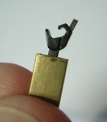

I won't go into body-mounting MT's since there is plenty of excellent literature on that.  In any case, I have been looking for alternatives to MT to avoid the slinky effect, so I started to look more at Accumates and McHenrys.  Since McHenrys don't come with pockets, one has to make something up for body-mounting.  I was intrigued by Bryan Bussey's idea of using rectangular brass tubing to make coupler pockets and came up with a minor mod that I thought I would share.  The basic parts are shown here:
The pocket is 3/32 x 3/16 brass tubing.  The Accumate is top left, the McHenry (with a 1-72 screw in the shank hole) is top right.  The mod I made is to use a 1-72 x 3/32 set screw (headless) in place of Bryan's 00-90 screw + 1/16 tubing combo.  Here is a shot of the set screw in place w/o the coupler (sorry about the Sasquatch focus):
To assemble, just start the screw, add an MT truck washer on the bottom (sliced a bit to fit), insert the shank, then set the screw.  The result, especially with the McHenry, is an extremely robust assembly:
It works equally well with the Accumates: (no more exploding Accumates with this)
In this example, the set screw is 1/8" back from the pocket face.  It should probably be back a bit further with the Accumate.
The advantages of this approach (all true of Bryan's version) are: extreme strength; customizable pocket length (e.g., extended draft gear), and relatively low cost.  The additional advantage of my mod is a slight simplification: no need for the interior piece of tube, and no need to trim the set screw.  The disadvantages are: the rectangular tubing is not trivial to work with (unless you have the right tools); the Accumates & McHenrys are really big; these pockets wont work with MT's because there is no easy way to install the centering spring.

As I noted in the Z scale forum, I was intrigued by the new Full Throttle Z scale couplers.  Functionally, these are basically smaller versions of the McHenry: similar shank design, and 2-part knuckle, except that the knuckle spring is a plastic leaf spring inside the pocket.  See DKS's extensive review for more info:
http://jamesriverbranch.net/clinic_2.htm
From my perspective, this is close to the perfect design, and they're close to the perfect size for N scale.  But (there's always a but) they are only available mounted on Bowser trucks and they're expensive: $5-6 a pair depending on quantity.  So this is only a test!
When I ordered them, I was expecting to remove the coupler from the pocket and fabricate a new one from brass (or something).  It turns out they are too small to work in the tubing above, and there is no convenient next size down that I can find, so I had to look elsewhere.  It took me about 5 min. to realize that I should keep the pocket, and the truck bolster hole, which gives me something like this, after slicing off the sideframes:
Here's a size comparison to the McHenry:
The top photo shows the pocket 'right-side-up', but I decided that it would be more convenient to have the pocket flipped over, so I inverted the coupler in the box.  Next up is a test on an Athearn tank car.
