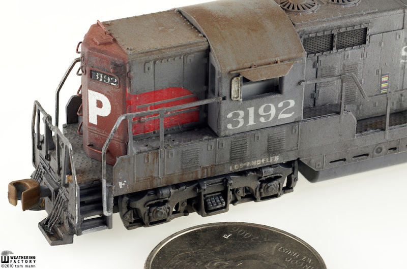

Re: Macro Photos In Z, How Close?
Reply #4 on:
July 15, 2010, 08:55:20 PM »
Quote from: Ztrains on July 15, 2010, 08:50:55 PM
it can be a fair amount of work to get them.
This took 10x the amount of work I "usually" spend. Not only is the weathering rougher, but now all the flaws in the model appear.

July 15, 2010, 09:28:28 PM »
"usually" being the key word of course!
Given how good your photos look I can imagine the usual time spent. For a special shot like this loco I can understand the time that has to go in to the photo.
Reply #6 on:
July 15, 2010, 09:31:30 PM »
Sweet geep! Hmmm LA under the cab, could this be for your layout?
