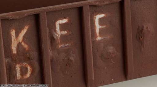

believable?  or not?

very nice .. but the decal film still sticks out ..

Believable. I especially like the rusty area under the K. And I don't think the decal film detracts--likely not as easy to spot with the naked eye.
true .. but .. the camera lens don't lie  .. it's still great work .. :)

I will say, however, that the Pencil Face avatar is really, really annoying...
Anyway, so what's the trick? Little puddles of epoxy or something like that applied to the surface?

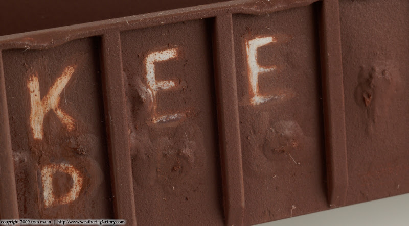

hold the phone guys...no decals needed here!
Little puddles of super glue.  Someone on this forum posted the idea back on aught five or so.  I think it was Red Rock.  I just got around to trying it! ;D

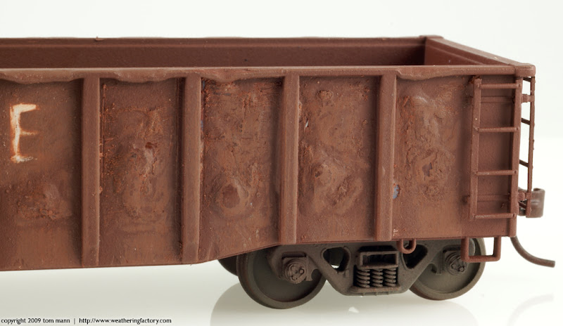

I bought a more liquidly CA to try to minimize the bumpiness.  To my eye, the first photo looked like those little round candies that are stuck to the paper! ;D ;D  After this new CA dried, I used a file and sandpaper to blend everything together.
thoughts?

« Reply #9 on: October 24, 2009, 07:52:33 PM »
I like the final version better. I agree, it looked a little unnatural.
The downside is that the INSIDE isn't all beat up.
Whoa...who said anything about "final"  ;D

« Reply #11 on: October 24, 2009, 08:48:09 PM »
The shapes are good, but I'm loving the coloration as much. It looks oddly "swirly" for lack of a better word.

« Reply #12 on: October 24, 2009, 10:57:37 PM »
I did this with a hot soldering iron from the inside.  This is one of the cars I lowered by cutting out the factory floor.  I did the dents before I took out the floor, hence the oddly high dent line.  On the inside of the car, there was quite a  bit of molten plastic blobs, so I filed them relatively flat, then use a Dremel with a cone shaped grinder to smooth it out to look more like bent up sheet metal.
I've got to shoot some more pictures... I don't have any handy of the car interior...

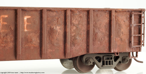

Stopped with the glue, now I'm working on coloring and texture:
Thoughts?

I like the color/texture -- do you have a proto pic?   The superglue bumps to me look more like heat melted than dents.
One thought, has anyone ever tried replacing the plastic sides with a thin sheet metal, like say a 0.005" to 0.010" brass?   Or perhaps a gon carbody kit using photo-etched parts?  Something like that might be easier to dent up than plastic.  (then there could be interior dents too)
