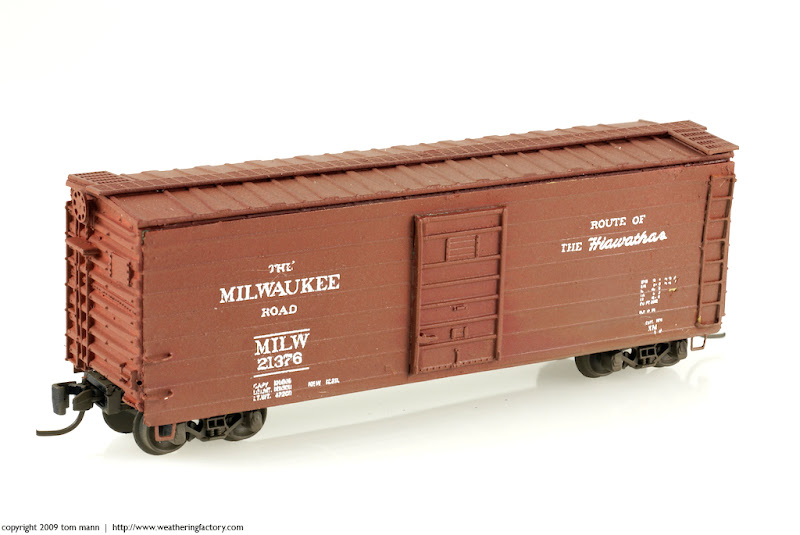

This is a team effort:  Chris made a brass overlay for the sides and Robert "lazed up" a thin, see through roofwalk.

Looks good, but how do the doors open and close or is that an unimportant detail in Z? ;)

That is awsome it amazes me what you guys do with Z scale great job Tom and the assisting team thankyou for posting.

Chris traded me one of those MILW cars he made up, and it proudly runs in my mostly NP consist.  His carsides really look good!

Looks good.  Is the roofwalk laser-cut wood?

I think it is styrene.

Yes, it's a thin translucent plastic that lasers surprisingly well. I have some of Robert's roofwalks and brakewheels, and will be putting some of them to use soon, in fact.

The roofwalk plastic is called 'Modified Acrylic". The stuff I got was .01" and .010" thick, but now it's available in .007 and .005" too. I got a sample of the .005" thick material, but have not tested it out yet. I used a raster pattern instead of vector cut to cut the slots, then vector cut the outsides.  ;D

Thanks for the info - it looks great.  Is this different material than the rapid prototype machines use?  Is it incredibly fragile?

Where can you get this stuff? I googled it but had no luck.
