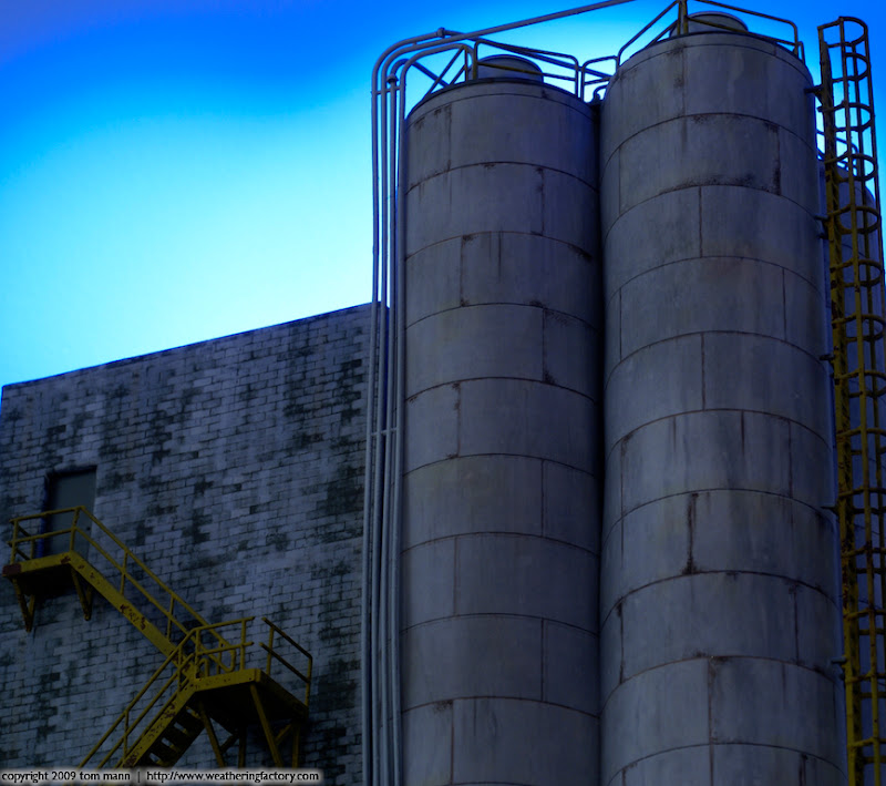

I got the idea to use textures on commercial kits.  The kit is Walther's Magic Pan Bakery, and the textures are from Clever Models.
Thoughts?  Believable?

Tom,
As usual, this looks great. Did you have issues with the repetitive patterns of some of their textures or are you just doing this on a small area for photography. I have been playing with the Clever Models textures (from the CD) to scratch build the Schlitz C-house (bottling plant). It is coming along, but I have a long way to go before it looks as nice as your stuff. Very inspirational...maybe that angelic light in the photo.
Best wishes, Dave

« Reply #2 on: August 28, 2009, 08:34:13 PM »
So far, the stuff I've built is smaller than the repeating texture pattern - so it hasn't been an issue.
thanks!

I still don't believe that's a model.  That's a prototype pic.
Awesome!

If that is actually a combo Walthers and texture model, all I can say is WOW!  8)

So what is Walther's and what is cardstock? Did you wrap the silos with something?
Re: walthers kit + cardstock textures
« Reply #6 on: August 29, 2009, 09:26:23 AM »
The structure is Walther's.  The cinderblock building and silos are wrapped with the texture.  The staircase is salt weathering.

Very nice.  It will take you forever to build a layout!  But it will look awesome to those of us who survive you... ;D
Cripe.  I guess we'll have to buy the next book to see the whole thing...
« Reply #8 on: August 29, 2009, 10:31:55 AM »
not really - it doesn't take too much longer to "wrap" the buildings.  And as Dave pointed out, raw materials are "made" with your printer, so costs are low too.
no, there is no book planned.   :)
Very. As Lee said, can't wait for the next book.

I'd Hate to slip down that staircase, that railing doesn't look like OSHA would pass it...  ;D
Lol... ;D
