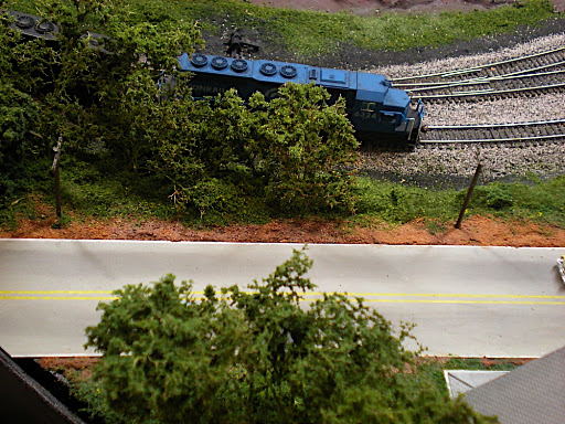

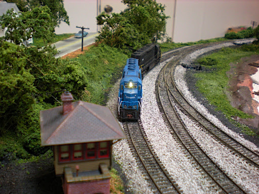

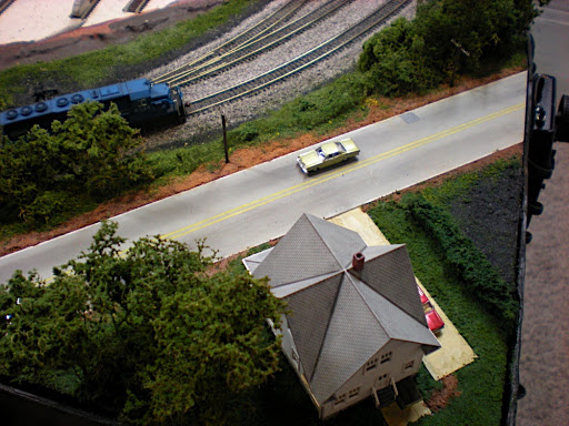

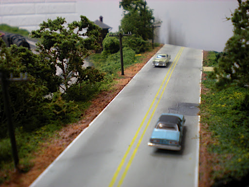

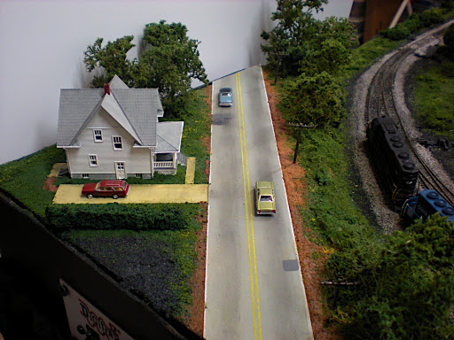

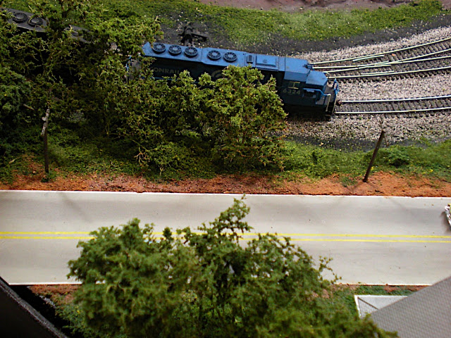

Okay, finished up the corner scene.  Lotsa pics.
That cinder lot is presumably from a business next door to the house.  The glue is still very wet in these scenes, so the haze & sheen is wet matte medium.
You can see PennDot has been trying to fix potholes on US 11/15.

Excellent Dave.  I like the treatment of the roadway - what techniques did you use?
Gotta love the mix of power in the yard there.  :)

The road is just a sheet of styrene from an old garage sale sign, spray painted with Testor's Dark Aircraft Gray.  The striping was hand-painted (using painter's tape as a mask) and the weathering is done by dragging my finger through black pastel dust and dragging it down the senter of each lane.  Dullcote completes the roadway.

An easy and effective technique that I'll have to remember in the future.

I like the blacktop patch too.  Nice work Dave!

Looks great Dave!
My only suggestion would be that if you really wanted to accurately model PA, you'd need to tear 11/15 up and add jersey barriers and a road crew.  :P

Who makes that house?
Looks like a good spot to live.
