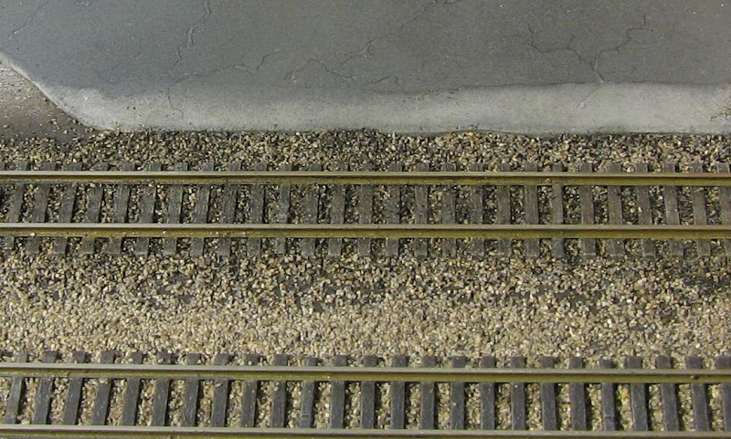

I'm with Ian and David in the camp that uses a pump-mist bottle (the misting kind is the trick) with straight alcohol about 12-15 inches above the rails followed by an eyedropper with a 50/50 mix of elmers white glue and warm water. I've found that the warm water seems to dilute the white glue a bit better. I use the eyedropper to apply glue down the center of the track and try to do it sparingly to avoid any floating stuff. I then use the capillary method of applying the glue to the outside edge of the ballast on each side of the rails. I should do an experiment to see if the capillary method will work to get glue all the way to the center of the track. If I could avoid having to directly apply glue between the rails, I'd have a few less miscellaneous floating rocks that I'd have to clean up later.
  • Posts: 14020
  • Respect: +4190
Re: Ballasting...beyond white-glue & water....
« Reply #19 on: September 11, 2009, 10:49:26 AM »
What an awesome scene .. I wish my ballast looked that good .. rocks or woodland?

Rocks.

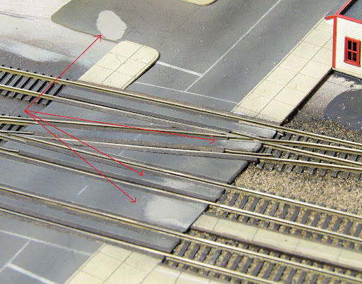

I used alcohol to wet my Z scale ballast and it left chalky marks in the paint I used on my roads:
Similar to what happens if you use alcohol over Dullcote, but I didn't Dullcote the roads.
Chris, I have noticed this happens sometimes when I use certain paints on items as well and then you get the chalk effect sans Dullcote. I've been covering my roads, or just hitting them with Dullcote afterwards. ModelFlex dark colors are the most frequent offenders for me.

It's possible that the alcohol was attacking the paint (alcohol is, after all, frequently used as a paint stripper). The test would be to spray the areas with a little Dullcote--if the color returns, then it was just some chalky stains; if the stains remain, it's a good bet the paint was damaged.
