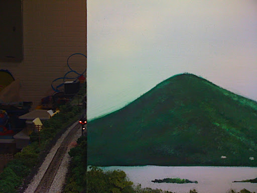

You're about a week or two too late for me...  I just did the old technique you mentioned, by crushing the code 80 jointers and then soldering the code 55 track on top.
It's hard to see, but it's just past the edge of the backdrop (I'm not too happy about the backdrop, BTW...  standby for changes like not having the Susquehanna River terminating into space!).  It's smooth enough that I can't hear the joint even with FVM wheelsets, but that was take 2.  Take 1 was pretty rough.
