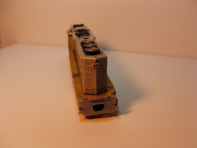

Hey. If you are going to this much trouble, add the two missing ribs on the blower cover behind the cab.

Thanks Ron,
I completely missed that!!
Hey Robb you are slippin mate!!! ;D
I'll stretch some sprue and glue it on, just as well I saw that today. It's only got one coat of paint on it ;D
Anything else that needs changing before it gets locked down with paint?

Yes!
Add a little styrene under the blower cover to fill that gap to keep the cats from crawling in. (or is that gap big enough for a dog to get in :-\)

Hi Ron,
The gap under the blower is because the shell sits up - Intermountain glued it down! With the brass walkways added on top of the sill it has almost eliminated the gap something like 0.25mm and given the walkway and lower part of the long hood will be painted black you won't see the slight gap. But I may add some 0.05 styrene to it hmmmm....... so much to do....!!! Yeah think I'll add it.

I didn't notice any boo boos. You're doing great! The gap under the blower housing was made by InterMountain. I wondered if the diamond tread filled it. The gap in your photo is simply because the shell is not sitting down all the way. OK - good job.

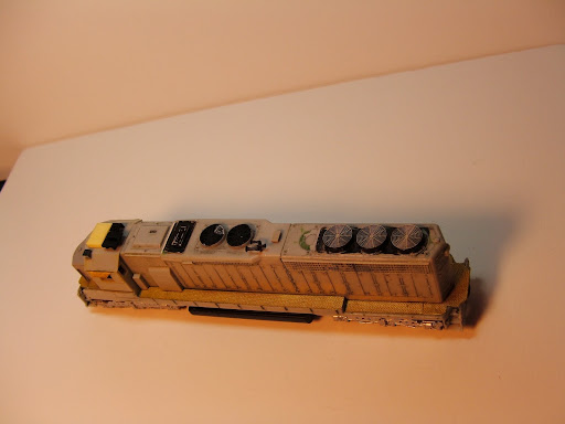

The blower duct is bolted to a flange on the walkway.... so you can use some .005-.010 styrene to make this flange and fill the gap. As for the missing stiffeners... they're also missing from the SD40/45T-2s...

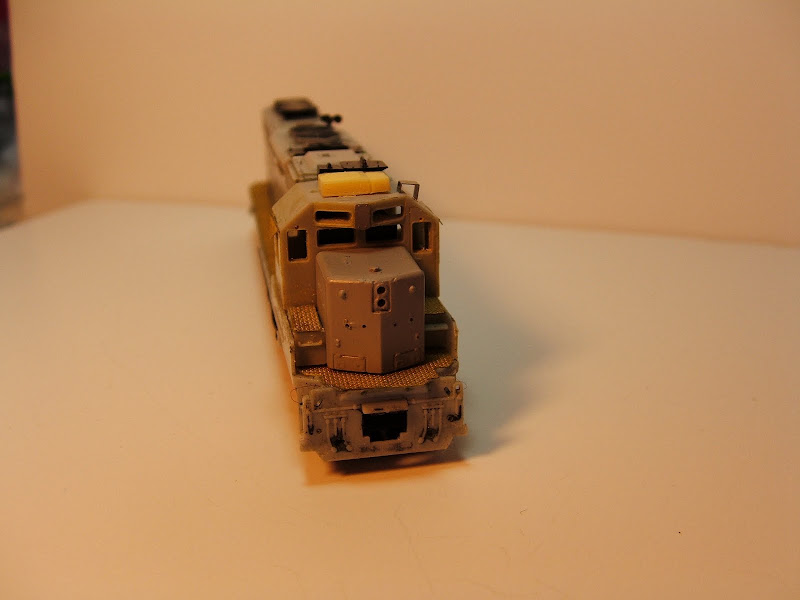

Hey guys,
Ya missed that poor excuse of an electrical box, it's wrong wrong wrong.................
Ya it's painted too!!!!!! I just hacked it off this arvo ;D
Here's a pikkie.
So now I have to make an electrical cabinet thingy to attach to the cab but it has to be rebated 0.5 mm grrr.
The cab design is err ummm quite different
Last Edit: November 21, 2009, 03:23:21 AM by kiwi_al

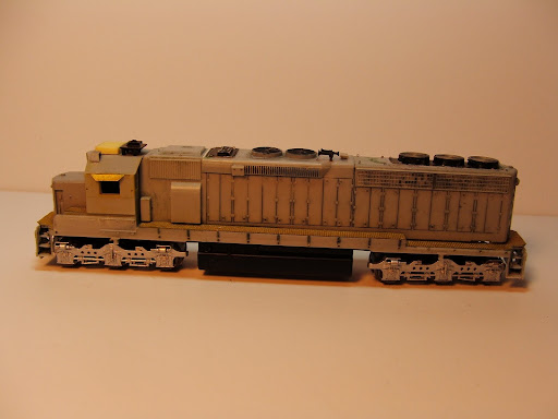

January 22, 2010, 06:03:24 AM »
oops I accidentally did something to this ;D :
