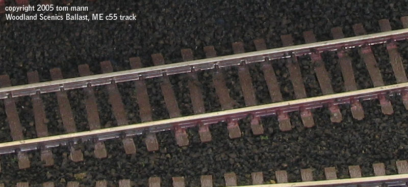

« Reply #6 on: April 27, 2009, 04:31:15 PM »
I'm all for Micro Engineering c55 with atlas c55 turnouts. The ME track is a bit more fine scale than the atlas track, smaller spikes and larger ties.
This is the ME c55 painted.
One thing to consider is that the ME track is much stiffer, if you bend it than it holds its shape. Some like this, others hate it
