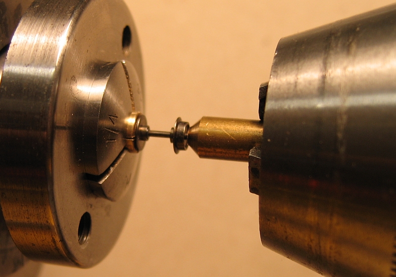

this is the way I suggest you do it (assuming you have a lathe):
few points
- you will notice that I do not have exact size of collet to suit the job, I have made an adapter to suit the wheels and fitted in an oversize collet (LH side in the headstock)
- on the RH side, in the tailstocK I have fitted piece of brass and made female end to suit the axle by centre drilling from the headstock, so that (providing you do not disturb it) it remains perfectly aligned with headstock
- if you want just to reduce the size of flanges, you can do the job on LH side, if you want more (like reduce the width of the tyre) you need to do it on RH side (near the tailstock)
and Bob is your uncle  ;D

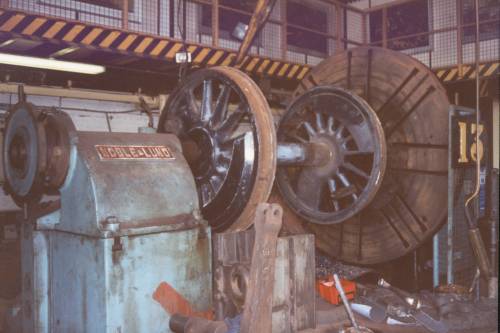

BTW - this method is nothing new, and follows full size practice:

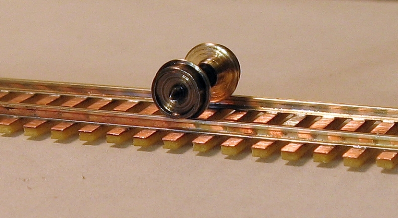

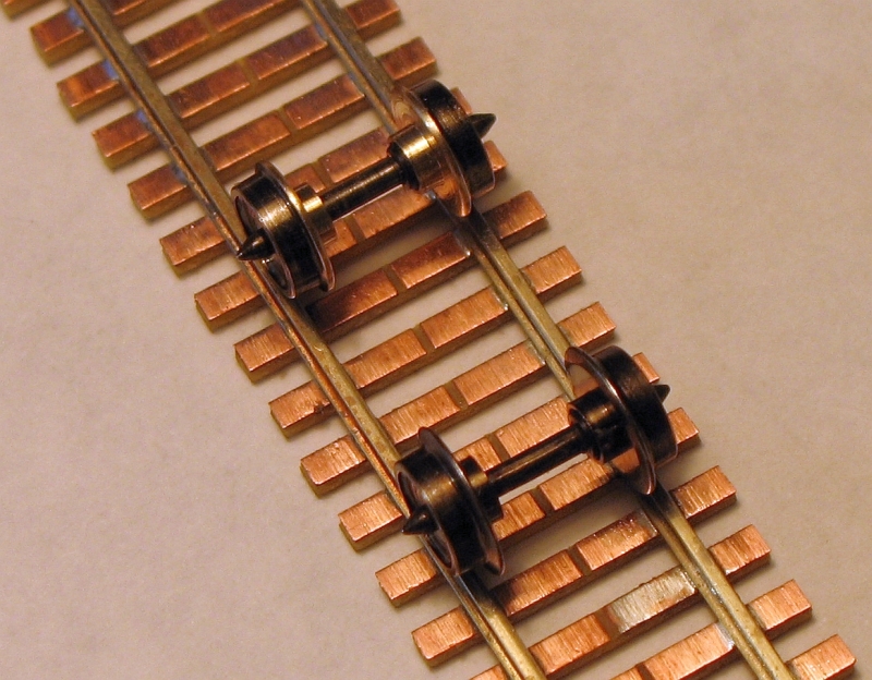

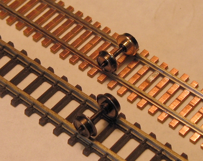

well, not exactly tomorrow  ;D, but here they are, before and after (I have used Marklin's pizza cutters for this demonstration):
Marklin's original and modified wheelset on code 40 rail
Side by side, Marklin's track and original wheelset next to modified one on code 40 rail
Whether this kind of appearance is worth the hassle, is up to you  ;) . . .
BTW I haven't bothered about tyre width.
This would also have to be addressed if the final result were to be considered fineZ
This experiment was just to show what and how it can be done.
