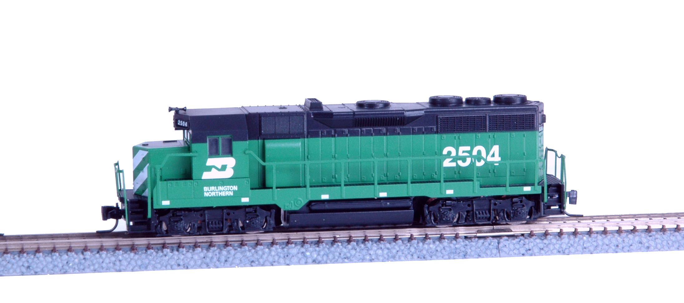

The wide bodies on the MTL GP35's have been bothering me since they came out... MTL didn't widen the trucks to match, so it looks like it's on rollerskates...  I finally tried slicing off the sideframes and installing .040" spacers to see if it would help.
As long as the layout is at eye level, this might be acceptable.

What an interesting idea...
Now you've got M-T trucks that are about as wide as the AZLs.

Great idea! I did this mod on my GP35s as well. The only difference is I removed the outter shoes since the units I model (BNSF, Santa Fe, BN) don't have them. They look a bit funkier then yours since you can see into them where the shoes are missing. Oh well. You win some and then you loose some.
I asked MTL about their SD40-2 and if they fixed this. No reply... I wonder.  :-X
http://www.rrpicturearchives.net/showPicture.aspx?id=598914
Can't find a well lit truck shot for all units in the series, but there's some evidence to suggest that the outer brake shoes and hangers remained on this series of ex-GP-35s.
