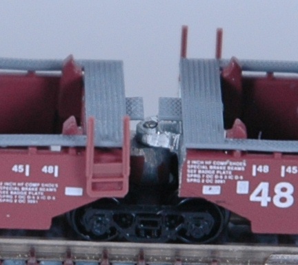

Had some fun making the MTL BNSF Husky's into something slightly more prototypical than single unit Huskys...   I carved up the ends and rearranged some parts to make a fully articulated 5 unit set, and just need to find some suitable "B" "C" "D" "E" decals to finish it off.

Not much too it, but here's a clearer photo of the articulated joint.  I didn't have to add any material, just remove existing.  I left the bolster in tact on one side, and then left a tab on the other.  I drilled from the bottom through the truck pin holes first to locate the pins.  The pin is just a short piece of wire in a #60 hole into the plastic truck pin.  I rearranged the stock MTL pieces from there to move the steps, walkways, brake details etc.  I may etch some new steps for the articulated joints, as they should be another rung lower... or just bend a stirrup out of wire to put below the plastic piece.

Mike, I cut my first car today, and its not as hard as I though. By the way, the only person that has Maxi III decals is Tim Buerling, but he is in a job in New Orleans. We dont know when he will go back to his home in Atlanta.

Mike, it doesnt look as good as yours, but it runs. ;D

Now just repeat for 3 more joints!  I got bored after 2, and let the project sit for a few months before finally getting around to finishing it...
