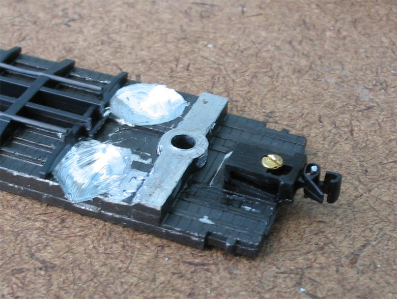

I'm curious, how do you guys who file down the bolsters get them even?  What I mean by that is, how do you file down each bolster the same amount and keep it level so the car sits straight?  I filed down some MDC cars years ago, and I was always concerned with the car leaning from end to end or side to side.  That's why lowering the bolsters is such a pain in the a##.  Does practice make perfect?  Thanks.
Jeff Lopez
  • Respect: +1736
Re: Fox Valley Models: Boxcar Height
« Reply #8 on: December 27, 2008, 08:07:52 PM »
Practice does indeed make perfect.  The first thing to always remember is to work slowly...file, check your work, file, check your work...you get the idea.  Also, invest in a good digital caliper to measure your results.  This is a perfect reason to have one and you'll discover many other opportunities to use it.
I've lowered over three hundred Micro-trains cars and I used a benchtop belt/disk sander on the disk with good lighting and an Optivisor.  I did between 10-15 per night after work when I could and it was quite easy.  It took no time at all to figure out where to sand to.  If I ever went to far which was seldom but it happens, I used my Dremel and a carbide bit to dish out enough room for wheel clearance.  Part of the process to begin with was to paint the trucks and convert to low-pro wheels.  Only occasionally did I have to file some of the ends of the underframe for coupler clearance.

The smart thing to do is to build a little jig to help you file evenly.  But I never made one... ;D
Practice does make perfect, but the key is to pick features of the underframe and use those to monitor the evenness of the bolster as it is filed down.  For example, on the MT 50' underframe, I file until the bolster is just slightly higher than the floor (the inside part of the floor, and higher because the frame is upside down).  Comparing bolster with floor makes it easy to see when to stop or if one side isn't even.
I also had a little test track to test leaning and wobbling.
Some ancient photo, from back in the day:

Tom,
I am having a hard time understanding your example above....higher than the inside part of the floor....but upside down. It seems a bit too Zen or possibly Jedi for me. Could you expand on this a bit, as I just don't get it. Will this be covered in your upcoming book "Lowering"?  ::)
Thanks, Dave
The bolster that is filed should end up just slightly higher than the floor (see above photo).
Thanks Tom.  I guess I got hung up on the "inside part of the floor" part.
