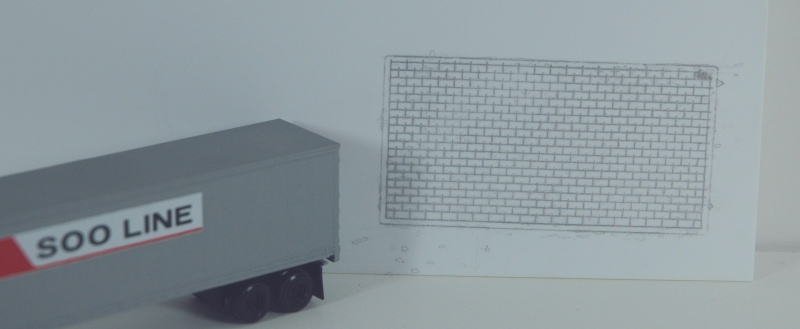

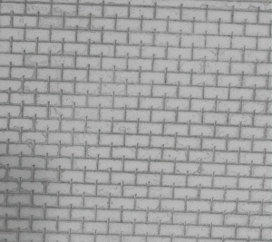

Skibbe is playing around with a vinyl cutter right now running styrene sheet through it to score cement block motar lines as no one makes a decent n-scale cement block styrene sheet. So far experiments are working. Soon as he gets me a closer to finished sheet I'll post up photos. I might try the rattle can Kilz 2 if you think the coverage won't be too thick and kill the detail.
In N, I wouldn't try it.  But the gaps in the HO cinder block wall were too large, so I wanted some to lay thick and give the illusion of smaller gaps.

I've got some overrun to correct, and think I can do it by reshaping the cutting blade so that it spins on center of the point instead of slightly off center.
Which cutter are you using? My wifes uses a Cricut blade that turns on center.
It's a Desay Master 380P or some such Chinese thinger...  Does the Cricut cut exactly on center, or do the blades look like this:
See how the point is at the edge of the cylinder, not directly on it's axis?  Never a problem with large vinyl window signs, but trying to cut N scale brick and cinderblock, it's causing issues.
Re: Franksville Wisconsin MiNi Mod-U-Trak modules buildout
« Reply #100 on: February 25, 2009, 02:30:25 PM »
Similar, but the blade on the Cricut looks to be a bit smaller so there maybe less travel. But then again I have not tried N brick as well, just window stuff. The Cricut blade however free spins, so it pivots on the point as it follows the CAD line. Send me your file and I'll see if I can test on a piece of styrene here.
Maybe you'll have to measure the over travel and then edit the cad file to compensate.
