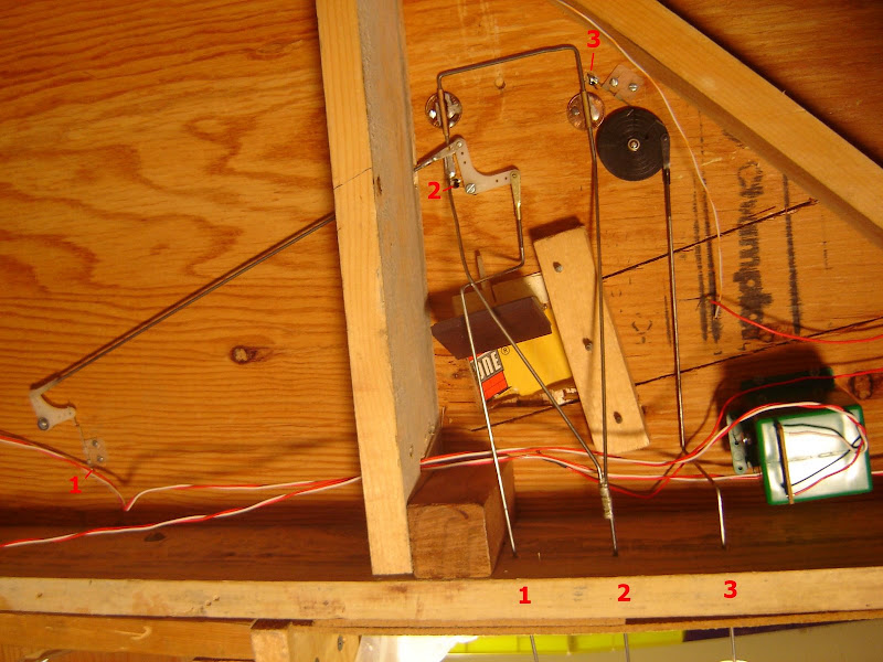

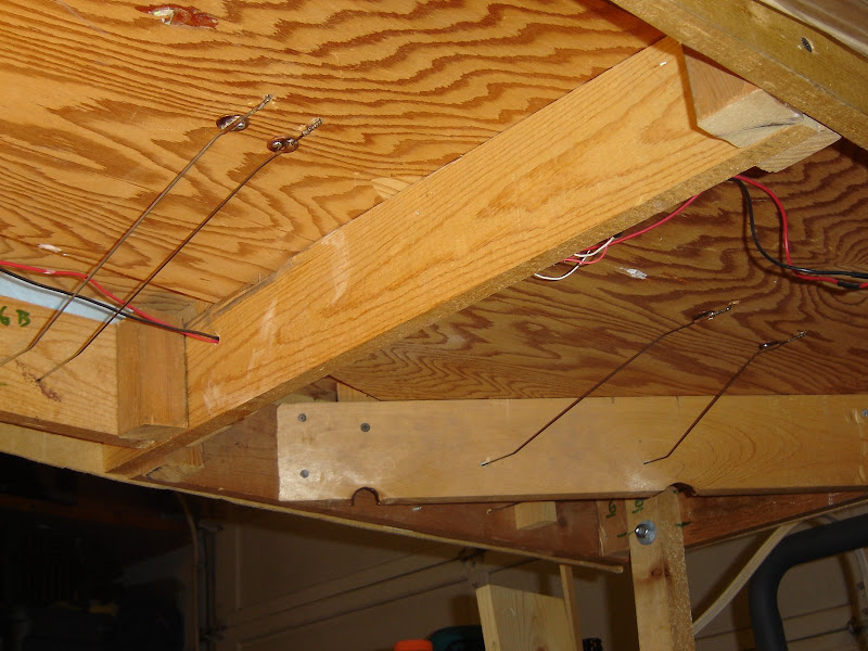

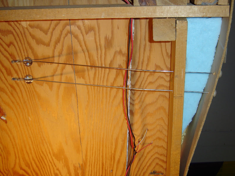

I spent the time I had this week working on the under side of the layout. I installed 1 new tortoise switch machine on the mainline and wired it to a DS64 and have started installing fascia mounted turnout throws for industrial/switching areas. This has been a very gratifying project. It's so nice to be able to flip switches from the fascia and watch them flip on the layout. It's nice to no longer have to reach into a scene in order to switch out cars at these industries.
4 out of 5 switches done in the Missoula area.
closeup of 2 of the 5 switches in Missoula.
This area was a tight squeeze! I was fortunate enough to have inherited a lot of old RC airplane bell cranks, clevises, push rods, screws, etc.

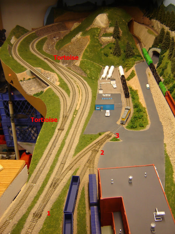

Here's what the topside looks like.
