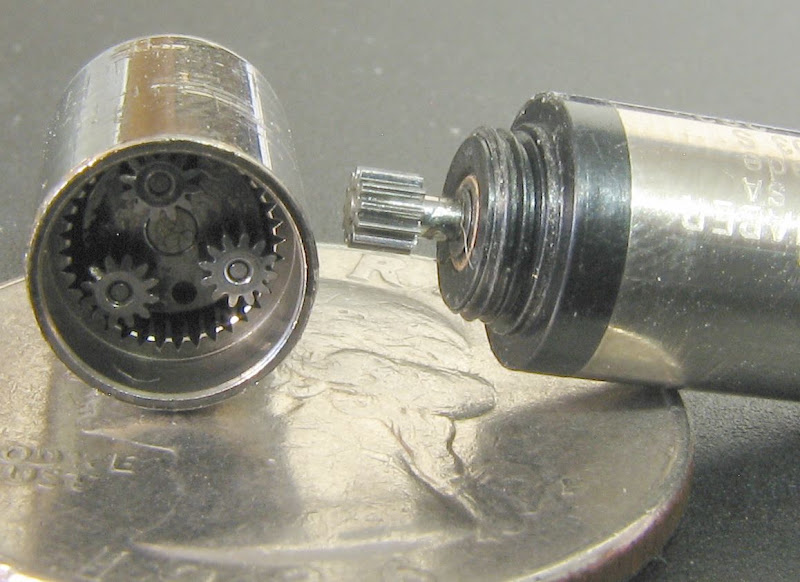

PS.
Here is the inside of a Tiny Tot:
And here is a Faulhaber:
