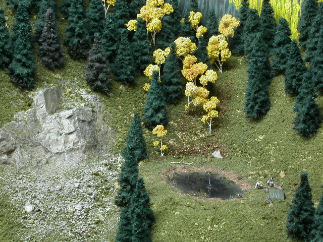

Here's my Liquitex Gloss Medium creek,  One of the middle layers is tinted with a drop of black and a little blue.  The second to top layer is drybrushed with white to simulate froth.
This is a Magic Water pond.  The base is painted with black with the edges airbrushed with dark brown to represent shallower water.  That's my wife and I camping by a mountain lake.

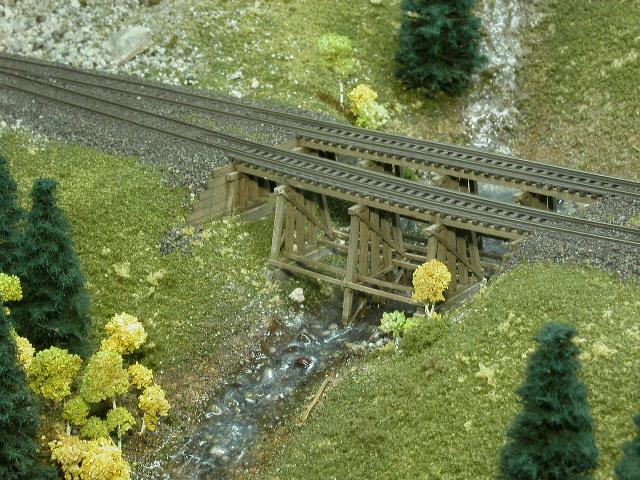

Hi all: Since I just joined this forum and am going through some of the posts, I hope this photo isn't too late. This is a stream that I used Magic Water.

Thank, guys. This is a great idea.  They don't just fade away, like old soldiers, as happens on some other forums. Here's another stream on my layout that's modeled after a real Stoney Creek. The real one is located North of Harrisburg. I have fished it a couple of times, and the name certainly fits it. This was actually the first stream I did. Originally, I used WS water. But after a couple of months, it developed unrealistic bumps and never really got hard. Dust was beginning to stick to it.  So, I covered it with Magic Water, and I think it turned out pretty good. I did use WS water effects for the waves.

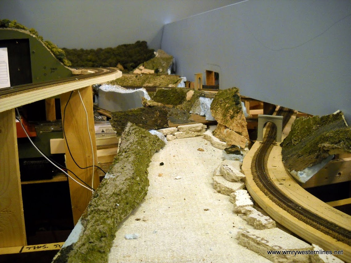

I'll update mine, too.  Since the tutorial I'd posted previously done disappeared, I can give you a quick synopsis based on the reconstruction going on now...
I started with a riverbed constructed out of some ceiling tile material I had laying around.  I put a skim coat of drywall mud on as a base and sanded it to be relatively smooth.
Basic scenery is Sculptamold, which is tinted with craft acrylic paints, and then sprinkled with some ground cover.
I use a blend of blue, green, black and some browns to paint the river bed.  While the paint is wet, I drop in some natural stones gathered from the Potomac River valley.  To my eye natural stones look better than plaster castings.  They certainly take less effort!

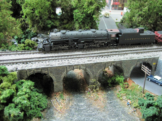

Once the paint dries, I go back with the first coats of Mod Podge gloss.
Then it's time to detail the banks with more little rocks, ground foam of varying coarseness and color, and some trees.
On this application, the Mod Podge did kick up some bubbles, but I like the way it adds some dimension to the surface of this "fast moving" mountain stream!
