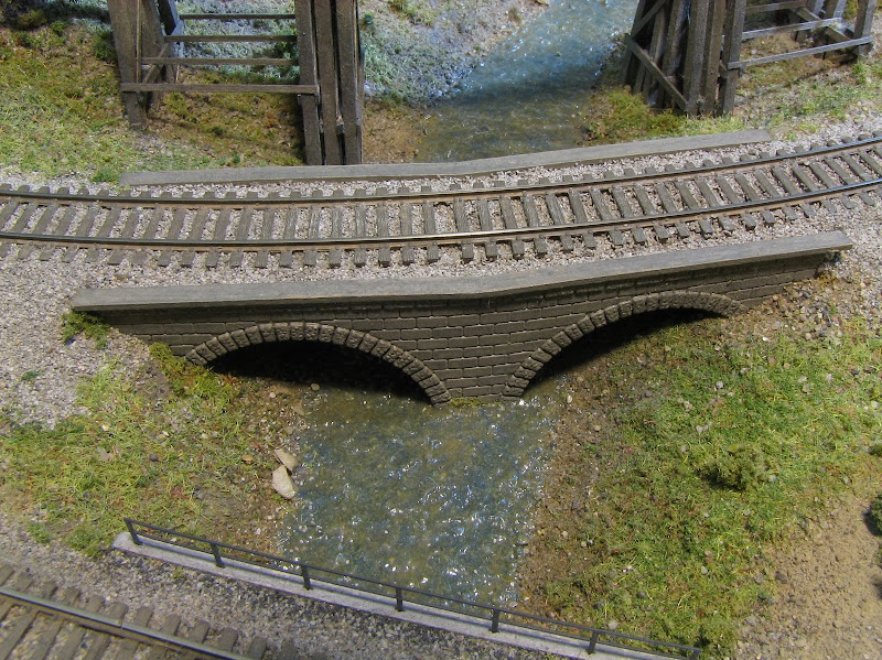

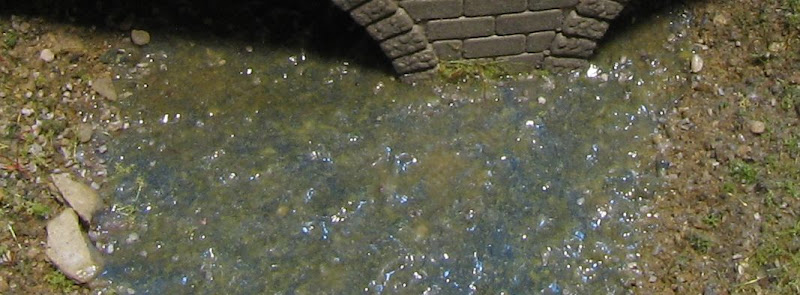

I don't think anyone's posted using Mod Podge Gloss.
This is a thin layer of wallboard joint compound spread on the blue foam board and then sanded flat. The color was airbrushed on to the joint compound and then about 3-4 coats of Mod Podge brushed on with the final coat going back and stippling with the brush to create the waves.
