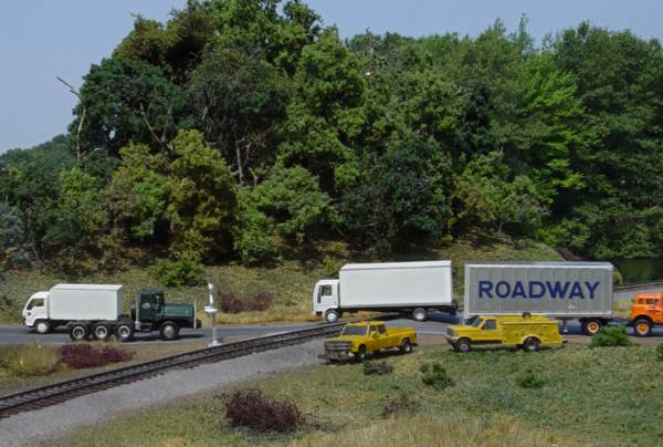

This was a photo modual taken in front of the waterfront. Half of the trees are real trees in the background while the other half are on the modual. Thanks to Helicon, it is almost a seamless transition.
Here is a close up of the trees. I use a lot of fine leaf foliage and super trees. The secret to super trees is to shoot them with Elmer's Spray Adhesive, wait 40 seconds then blot on Sweetwater Scenery's branch fibers. After this has dried, use the old hair spray and medium ground foam.
This was my first photo modual. I wanted the open look of an viaduct near water. The trees are shorter. There are several "false trees". There are simply trucks without canopy. The added trucks gives us the ilusion that there are many more trees then there are, while not over crowding the canopy.
Here is another angle. There is a lot of underbrush. I used mostly weeds and dark earth ground foam under the trees. This creates a shadow effect, contrasting the trunks and canopy. I never use green under trees as there are very few green plants that grow directly under trees.

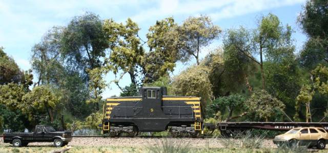

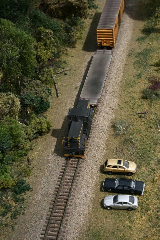

Heres some scenery i did on the layout let me know what you think
JEROME
  • Posts: 26206
  • Respect: +11755
Re: Interactive Scenery Clinic Week1: Ground Cover: Trees: Shrubs
« Reply #58 on: May 08, 2008, 11:44:44 PM »
I love that ex-LMS unit!
I think the front row of trees could be taller and have some trunks.
I also am not a huge fan of the JNR prototype Kato towers, but this is about trees, not structures (week 4 maybe??)
