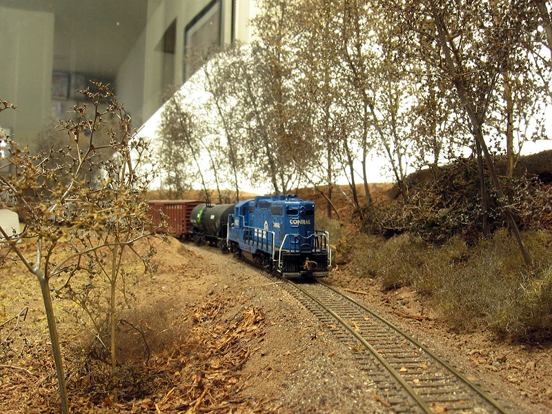

What an awesome thread and what talented modelers there are out there! Here's my theory on the following subjects:
Transition area: I observed the real world, and, in my area, I noticed that adjacent to highway and railroad right-of-ways, there often is a taper in height from ground cover and brush to the trees that become the forest. So, on my layout, I used Scenic Express turf and flock as the ground cover and Woodland Scenics Fine-Leaf Foliage in various shades to represent the brush. I blended these materials together and used them to transition to the forest.
Trees: I use trees with trunks, because I have a small layout and do not believe that I could effectively force the perspective to get away with modeling just the "tops" of the forest canopy in the distance.
I think a lot of people really under-estimate the height of real trees, so, to me, poly-fibre balls and ground foam always look like just that and do not capture the look of a real forest. There needs to be the vertical element. To effectively model the forest canopy, I believe that you must force the viewer to believe that every tree has a trunk in your woods. To do that, the first row of trees, at a minimum, must have trunks and be tall. That is, the entire tree in the first row or rows must be modeled. This scene is a long way from being finished, but look what trees that are not too selectively compressed in height do for it.
Dave Foxx
Rising Sun, Maryland
P.S. Sorry to recycle old pictures, but I'm still at the office. I couldn't wait to get home to respond to this great thread.

Re: Interactive Scenery Clinic Week1: Ground Cover
Reply #27 on:
April 30, 2008, 08:33:01 PM »
Oh man, Dave Foxx, I think it's something in the water supply around here, because you just said almost EXACTLY what I'd have to say about trees!
I'd just like to add that I think even commercial trees are WAY too small. Take a look at the way these relate to the train:
3 times the height, at a minimum.

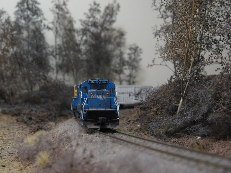

TheCRHS.org
Posts: 12414
TRW Plaid Member
+8823
Reply #28 on:
April 30, 2008, 09:31:57 PM »
Ed,
We are definitely on the same page when it comes to modeling trees. The scenery, including trees, should dwarf the trains. Don't get me wrong, trains are big, but Mother Nature is much larger. In my case, I just don't have the time or the desire to hand-build the hundreds of trees it will take to cover my layout. I think the selective compression of the height of the trees that I chose is a nice balance between size and cost. The manufacturer of my trees does make taller trees, and I admit that taller would look even better. But this isn't exactly the dream layout, so I'm willing to compromise here and there without losing sleep. Your scenery, by the way, looks fantastic! How are the rest of us supposed to compete with that?!
Dave Foxx
