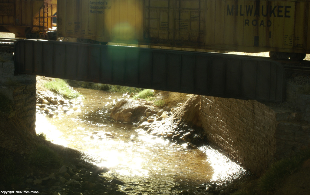

Yes, it depends on what type of water.
I like Magic Water.  It dries smooth, like a pond or lake with no wind.  I use gloss medium on top of it for rapids:
« Last Edit: January 17, 2008, 09:12:16 PM by tom mann »

How did you create the rapids in the gloss medium?
Re: best item to use for modeling water
« Reply #14 on: January 21, 2008, 12:42:33 PM »
I use a stiff bristled brush and dab it on, occasionally dabbing it while it dries.
