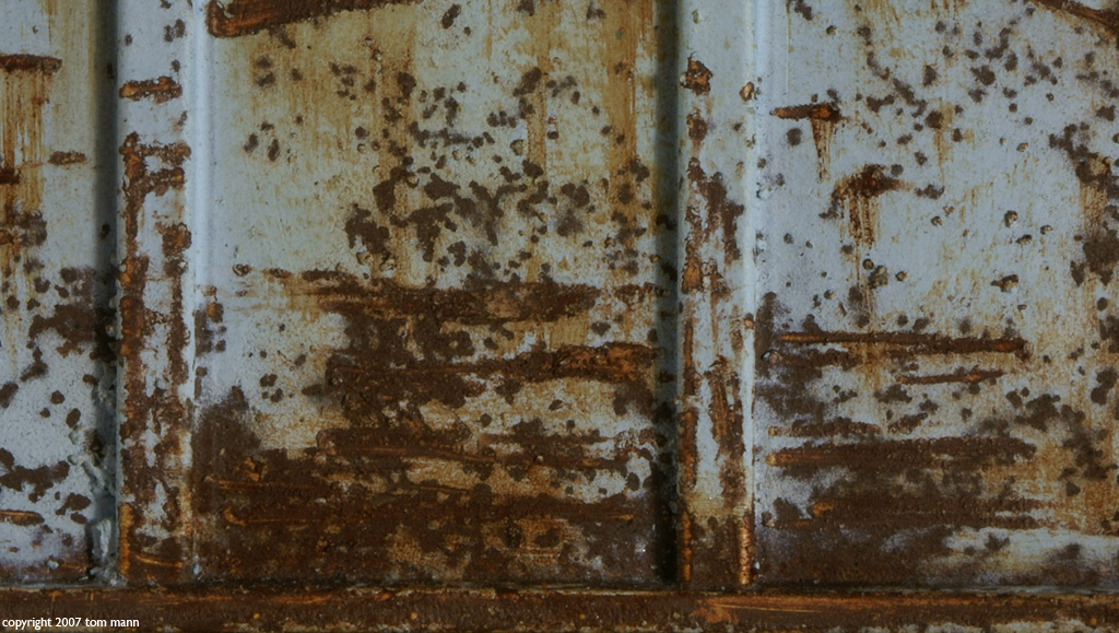

This car is pretty much utilizing the same techniques as the last HO car, but I was a little more judicious with the sea salt and instead tried to get more of a horizontal scratch look.  To get the scratches, I gouged the blue paint after it dried with a toothpick and the corner of the little plastic piece that is included in an MT jewel box.  And then it occurred to me:  the rust is under the paint, like in real life.  I only had to paint the streaks (with oils).

Well, let's see.  This doesn't include setting up the airbrush, mixing paints, or cleaning the airbrush.
1.  1m Remove trucks and wheels.
2.  2m Paint wheels with Krylon Rusty Metal Primer.
3.  5m Paint trucks with Rust/Grimy black.
4.  4m Paint entire car with Krylon Rusty Metal Primer.
5.  10m Dust car with Engine Black and Rust.
6.  5m Apply salt.  :)
7.  15m Paint car blue (Reefer White with Avon Blue).
8.  2m Use masking tape to mask off areas for darker blue (only let the tape attach to the ribs, to get a "soft" separation line).
9.  5m Paint areas darker blue (Reefer White with Avon Blue).
10.  60m Remove salt and scrape areas as needed.  This step allows the rust base coat to show through.
11.  4m Paint roof with SophFin Iron paint.
12.  75m Use Burnt Umber and Sienna oils to make streaks.
13.  2m Paint roof with SophFin Applicator.
14.  20m Make bottle for baby, feed.
15.  30m Inspect streaks with macro lens, fix as needed.
16.  2m Paint roof with SophFin Applicator.
17.  5m Mask and paint blue reporting mark area.
18.  3m Paint couplers and coupler box Rust/Grimy Black.
19.  7m Lightly soften edges of rusted out lettering with light blue airbrushed paint.
19.  5m Change diaper.
20.  30m Decal.
21.  5m Dust decals with Polyscale dust to remove sheen.
~280m, 5 hours.

Tom - What does sea salt do?
nscalesteve
Re: HO Scale SRN Boxcar
« Reply #14 on: November 14, 2007, 02:42:01 PM »
...sea salt quickens the corroding process !
