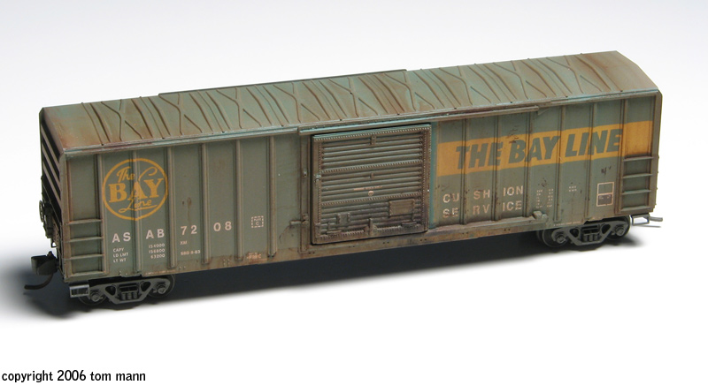

Does anyone have any sugustions on how to weather cast on ladders to get a natural look? this has been something thats bugged me...
Use a nice dark wash...maybe burnt umber and ivory black mixed?
Just enough to make them pop out a little bit:
http://www.mannresearch.com/rr/asab/boxcar_01.jpg

Thats the look I want!
I've noticed that once my wash is dry the paint has gathered around the edges of the cavities between the grab irons leaving a ugly light spot in the middle... (I hope that explains it :P)
Is my wash to thin?

Re: Solid Gold
« Reply #11 on: October 13, 2007, 01:40:19 PM »
Is my wash to thin?
Yeah probably, sounds like the wash is puddling. I usually thin the artist's acrylics to about the consistency of model RR paint, then apply only where I want it and wipe down the excess. Work on a small area at a time so you can clean it up before it dries. Here's an example of a yellow car:
