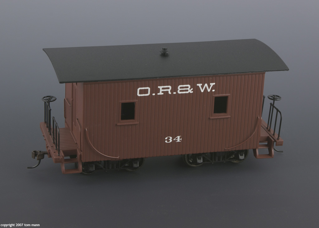

I've always admired the Bachmann On30 equipment that MicroMark carries.  Last week, I decided to order some. ;)  I was a little shocked when I opened the boxes: the quality was good, but they looked a little toy-like.  They looked too plasticy, without any textures.  This is ok in N and Z, but far too noticeable in O.  So let's do some weathering to capture a poor, depression-era narrow gauge railroad.   We won't go overboard like Malcolm Furlow would, though!
This is the out-of-the-box caboose (well, almost - I popped out the glass).  It's a lighted model with an interior and separate wire grabs, a great deal at $22!  But the wood slats have no grain!

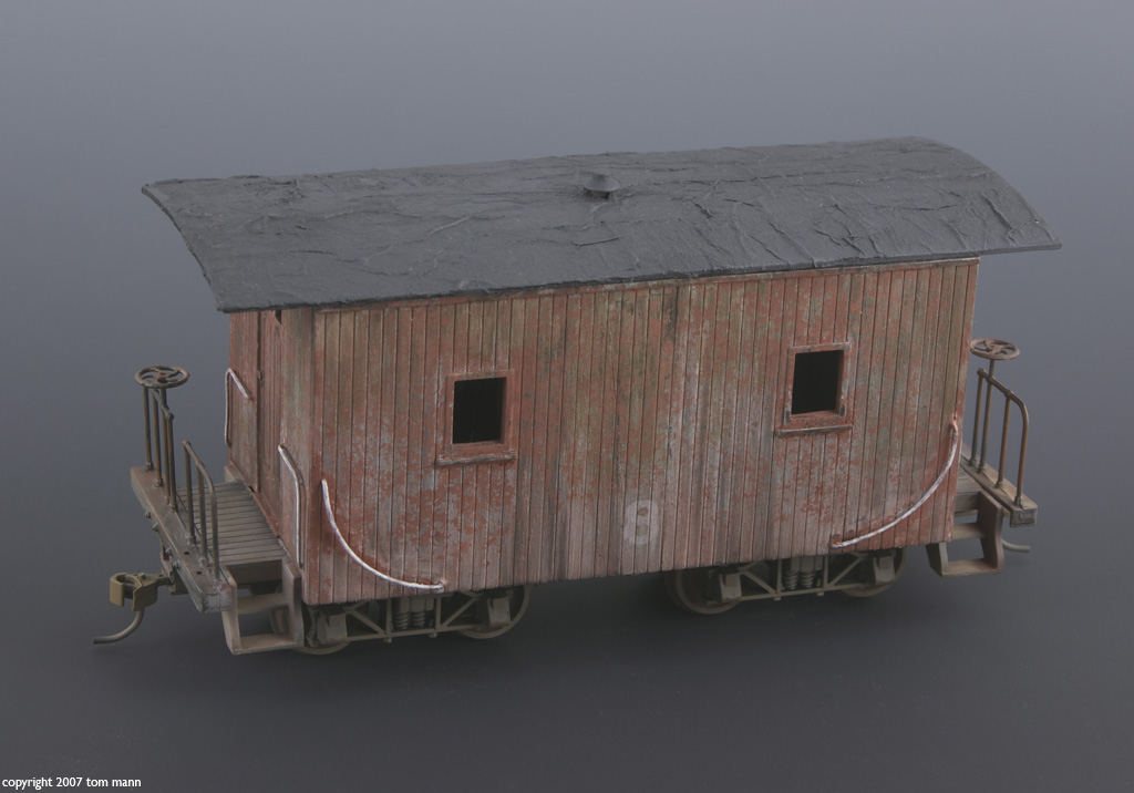

The first thing that I did was sand down the model with 60 grit sandpaper to give the wood a texture.  I then followed the advice on the Pacific Coast Air Line site to make the plastic look like aged wood (http://www.pacificcoastairlinerr.com/aging%5Fwood/).  I deviated from the directions a little, using a base coat of gray with a light coat of Kilz and paints instead of dye.
After the "wood" dried, I wetted the model and then sprinkled on a liberal coat of sea salt (not square), going heavier near the bottom.  I painted that with a coat of boxcar red and special oxide red, probably about 50/50.
The roof is toilet paper.  I was trying to go for an aged tar paper look, and really have no idea if I did or not ;D

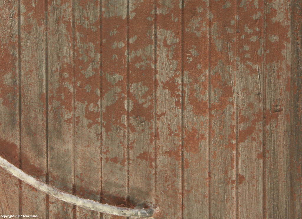

A close up show off the texture and peeling paint:
This was a fun project to do, mainly because of the large size.  I have higher quality trucks and wheels on order, and I need to figure out what to do about the glass.

Looks great as always, Tom.  Can you explain the "sea salt" technique a little more?
When are you going to do the 2-6-0? I can't wait to see that!
  • Posts: 26164
  • Respect: +11690
Re: On30 Caboose
« Reply #12 on: August 11, 2007, 03:43:28 PM »
On a second glance: the paint hasn't uniformly peeled under the handrails. That looks kinda funky.
Re: On30 Caboose
« Reply #13 on: August 11, 2007, 04:45:54 PM »
Sprinkle on sea salt to a wet surface as a mask.  Paint over the salt, and after it dries, brush the salt away.  The areas underneath the salt  appear!  So in this case, I painted the entire side to look like old wood.  I sprinkled on salt, and painted the red.
Note that you should use sea salt because it is randomly shaped as opposed to table salt because it is cubes.  Yes, this shape difference is noticeable.
Ed, you are right.  An oversight thanks to a lack of salt underneath the grabs. ;D
