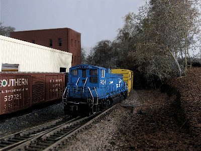

Last night I started painting the windows on the factory building in the background here:
It is the most BORING, REPETITIVE and incredibly intricate process I have come across in model railroading.
This comes from the fact that all of the windows and doors are cast into the walls, meaning that you can't paint them seperately, you HAVE to paint one, then the other.
So I spent an hour doing one wall's worth of windows with a tiny brush. It was a real pain because you have to work inside the window area, and make sure to get the window frame but NOT the brick around it. Friggin impossible.
Needless to say, the windows look like crap now, and there's not a whole hell of a lot I can do about it.
Anyway, just needed to vent.
