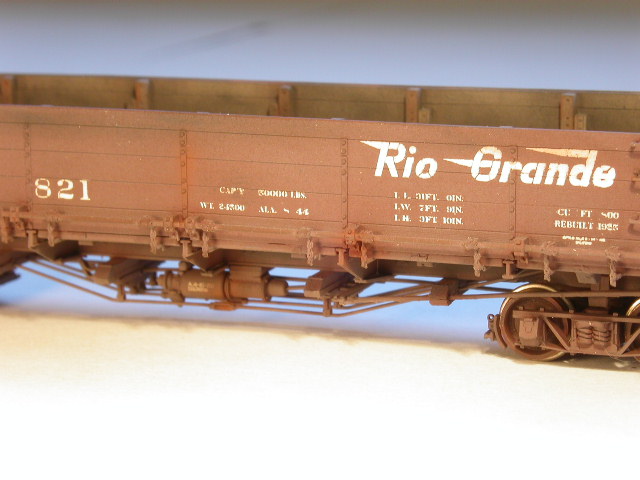

This is an HOn3 Grandt Line D&RGW Drop Bottom Gondola kit that had the weathering, specifically the rust and soot covered wood interior, toned down after it appeared too bright in close-up photos.

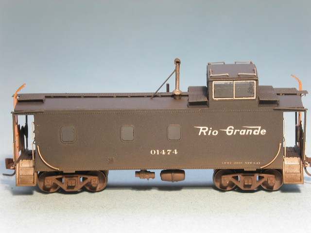

This is a recently completed N scale Trainworx D&RGW caboose kit that in photos, to me anyway, has a bit too bright a dirt color on the trucks.  When viewed on the layout, with ample overhead lighting, it looks much better.
