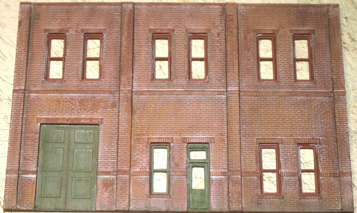

I had some white Guache so I did the first panel. Buffing just paused to paint to pull completely off so I opted to remove the excess paint with a Q-Tip and alcohol. It did did remove some of the paint, but on areas the I tried to remove all of the paint from the top of the bricks, I ended up removing it all. So I had to go back and re-apply dry bushing. Here is the before and after. So far I'm leaning to how I can vary the look of the brick w/o mortar. However, the test panel looks better in the photo than it does in my hand. LOL

I've always used concrete or off-white colored, water-based acrylic paint thinned down with water to create a wash, which wicks/capillaries into the motor lines nicely when the wall is lying flat. Takes a while to learn how to get the mixture right and sometimes it takes more than one application, but I find the results to be very good. About on par with the photo above where flour was used.

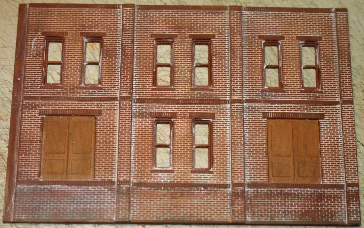

I got my order of Roberts Brick Mortar and it was quite easy to use and the effect is pretty good. After the initial buffing, I had to go back with a barely damp cloth and rebuff twice to tone down all the white grout. You will need to use a knife blade to go into the corners of raised details to remove the excess mortar that accumulates there.

Yes, that looks very good.  Yes, we all know that in N scale structures the mortar lines are greatly exaggerated, but it just looks "rigth" to me. Like a real brick wall my brain expects to see.  Without contrasting mortar, the brick wall looks dull and not realistic to me.
