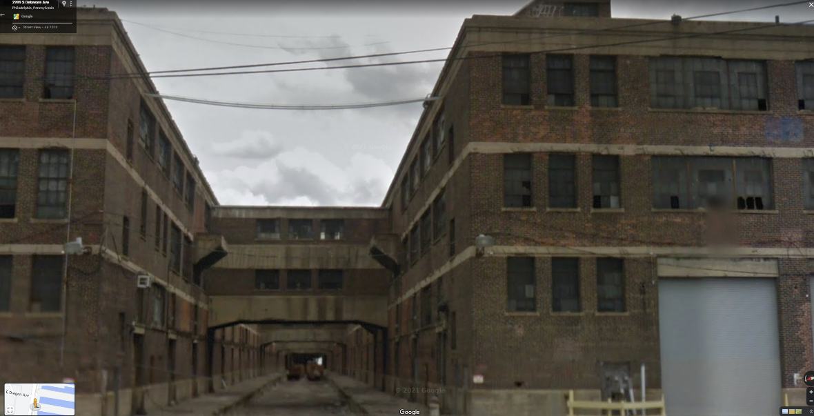

As for looking at existing buildings in the area, I-95 and pier redevelopment took out almost every one. There is one left, the US Army Supply Base at Pier 98. Here is what it looks like. You can clearly see how dirty and grimy the building still is.

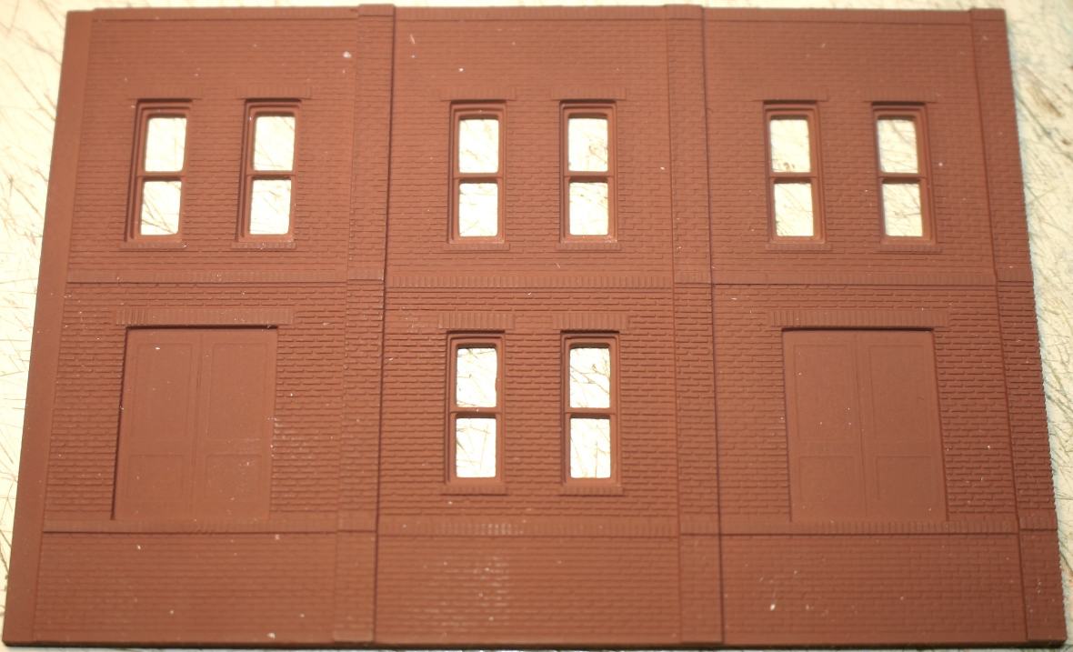

I must be spastic. I could not get the flour to stay in the grout lines. So I am making some test pieces to try oil washes. The colors I want to use arrive either Friday or Saturday. I have no clue if this will actually work but is does for dark accents. Why not light? First the red oxide primer.
Then some dry brushing to get color variations. I misplaced my 00 brush so I could not do the window frames just yet. I will seal this with dull coat tonight so nothing affects this layer.
