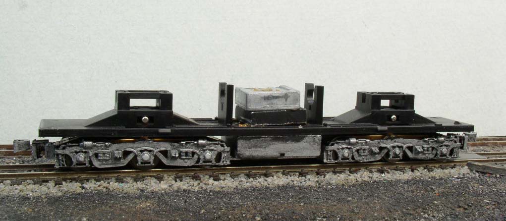

OK, so on the B units - Life-like dummy B's can be hard to find by themselves.  A's were easier, I ended up with two.   The stock dummy chassis is the plastic one with a fuel tank weight, which proved that it was just way too light to track properly even after gauging.
Link:  http://www.randgust.com/PABX101.jpg

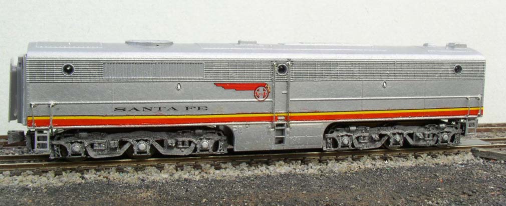

Stock B shell is quite nice.  The only inaccuracy on these I can find is the stack position that was modified on ATSF units.
Link:  http://www.randgust.com/PABX102.jpg

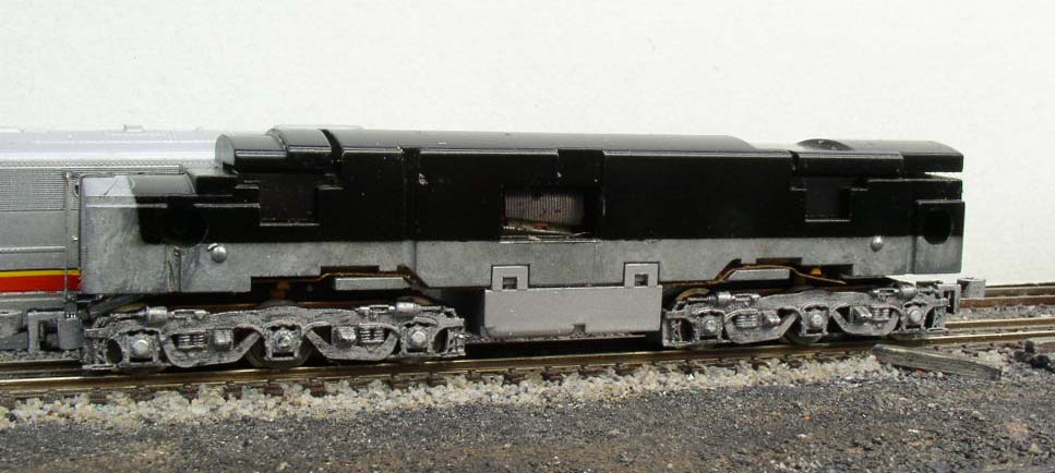

On the powered B unit, I got a powered A and was surprised that this one was the 'second generation' split frame, ran well, but converting it a a B unit?
Link:  http://www.randgust.com/PABX201.jpg

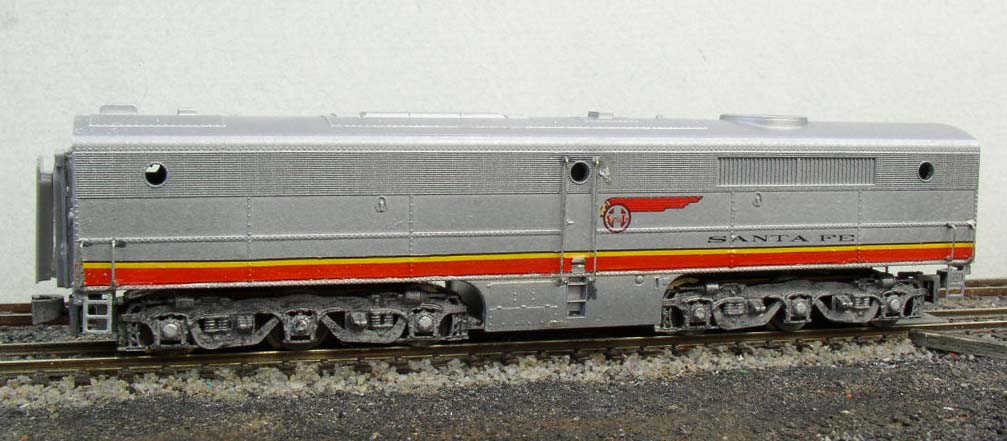

Rather than buy another LL B unit at an inflated price, I got a Kato B unit shell undecorated for this one.  It also has the right stack position and fits just fine on the LL drive.
Link:  http://www.randgust.com/PABX202.jpg

If you look where the motor should be on that frame, I already added two block lead weights, had to do the same with the dummy A unit (#70) that has the exact same frame.  Stock was just the lead in the fuel tank area.  Both the dummy A and B tracked terribly as soon as a reasonably heavy 9-car passenger train was put behind them, lots of derailments.  But the powered A and B could pull way more than this.
They don't roll all that well, but they aren't awful either.  The big issue on all of these was wheel gauge on those long-wheelbase trucks.

Randy, I just noticed that the frame pickup strip on the right truck is not properly aligned.  You probably already fixed it, but just in case, I wanted to let you know.
  • Posts: 3289
  • Respect: +3010
Re: The Alco PA1 project
« Reply #21 on: June 12, 2022, 09:00:49 PM »
Yeah, I noticed that in the photo as well and put it back in place.  But I never noticed it while running, what can you say, that mechanism is just a tank.

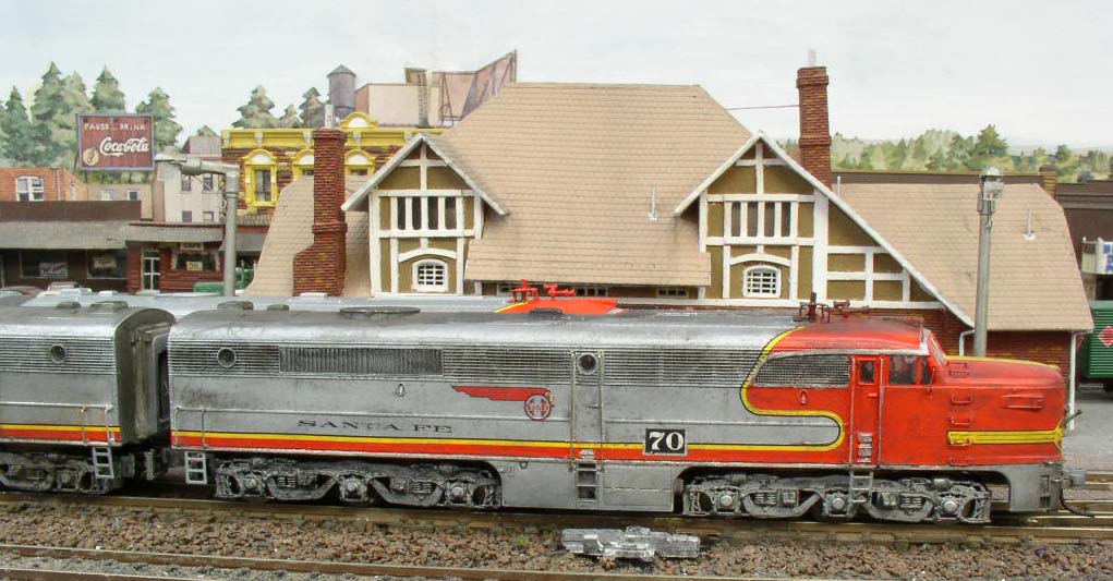

I tried the diaphragms, and while they look great, they caused all kinds of derailments on the dummy units.   Frustrating weeks of tweaking and testing, finally glued them solid to make sure they wouldn't snag.  Added a lot of weight, put a lot of miles and testing on them.
So after that, finally have gotten brave enough to weather.  Dummy 70 and the PB dummy are weathered, the 65 (with masked off windows) is for comparison, unweathered.  This is the kind of '67 appearance I'm after, lots of dark smoke weathering on the roof, horns, radio antenna, relatively clean sides, more dirt on the nose.  One of the things that I noticed on weathering is the shutters under the radiator fan, and the grille section INSIDE the warbonnet curve, accumulated more 'grime' than the rest of the grilles, but it was very consistent in period photos. And a decidely 'orange' cast late in life on the warbonnet red rather than the usual warbonnet red you see on models, which is why I wanted to do my own paint rather than start with a factory job.
Link:  http://www.randgust.com/PAA7004.jpg
Link:  http://www.randgust.com/PAA7006.jpg
Getting there, looks like I want even in photos.
I may have actually ridden behind them as a kid either on the Grand Canyon or the San Diegan operation, but what stick in me is the Green Frog video shots of them accelerating to about 90 and just belching clouds of black smoke late in life.   Remember, 244 not 251.

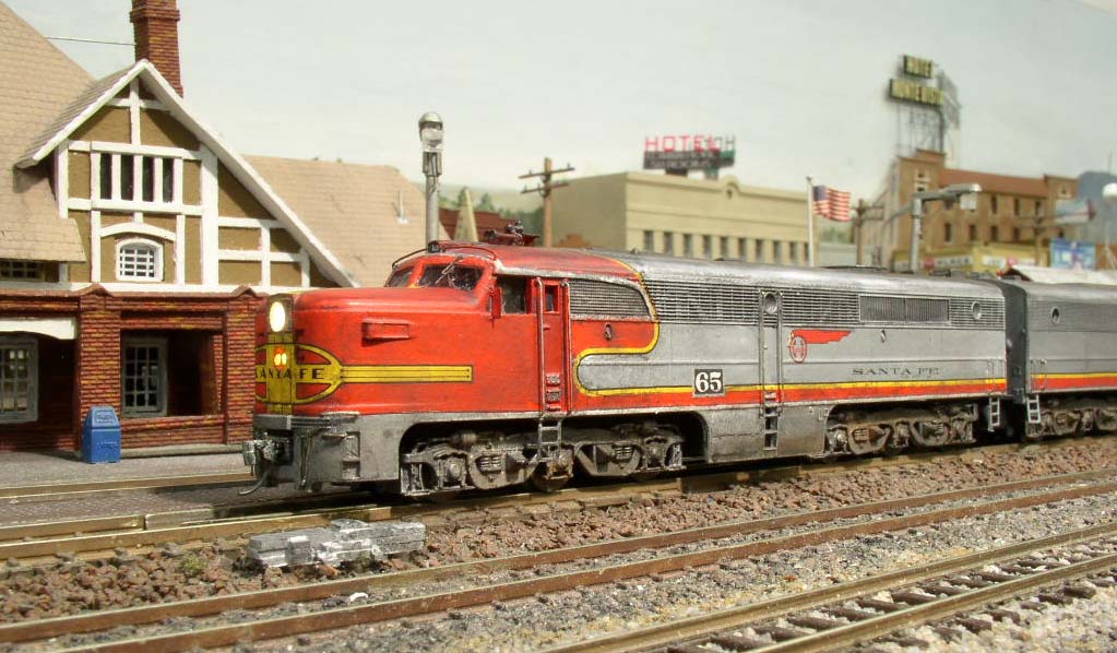

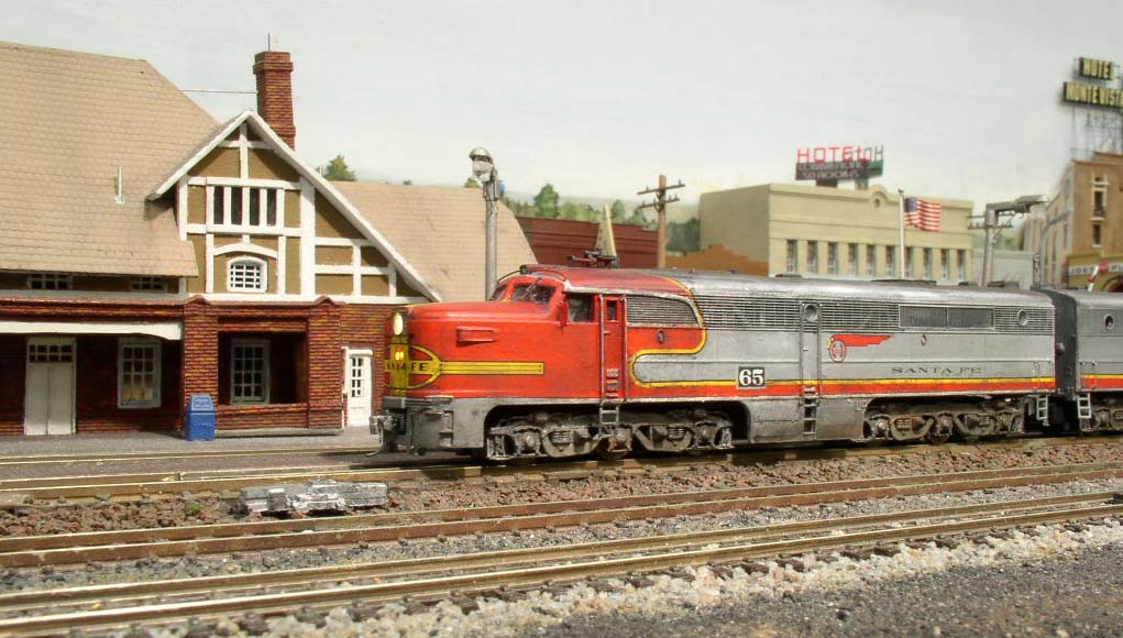

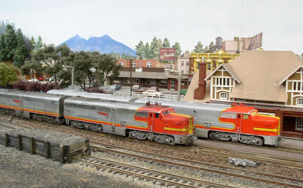

OK, I finished up the other A unit - 65 - through weathering....
Link:  http://www.randgust.com/PAA6501.jpg
Link:  http://www.randgust.com/PAA6502.jpg
So, the last great thing I still want to do here on the thread is assemble the ABBA set with all the various cars I've accumulated for the end-of-life "Fast Mail" and do a short video.
Oh, and yeah - 65 has a Z scale coupler in the pilot as it's the powered lead unit with the Mars light package in it, 70 has a regular MT coupler although it's a silver one, it's the trailing unit.
Even dragging around two dummy units. two powered units have more than enough TE to handle a long, long train.   And they are extremely quiet and reliable now.
