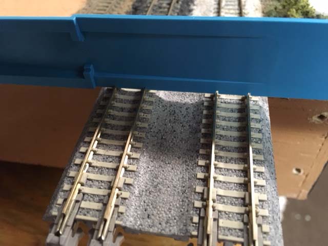

another example...
the module's track, on the left, was aligned and spaced with the Kato rerailer tool.
The track on the left is the Kato concrete tie doubletrack piece.
Bruce M. Arbo
CATT- Coastal Alabama T-TRAK
