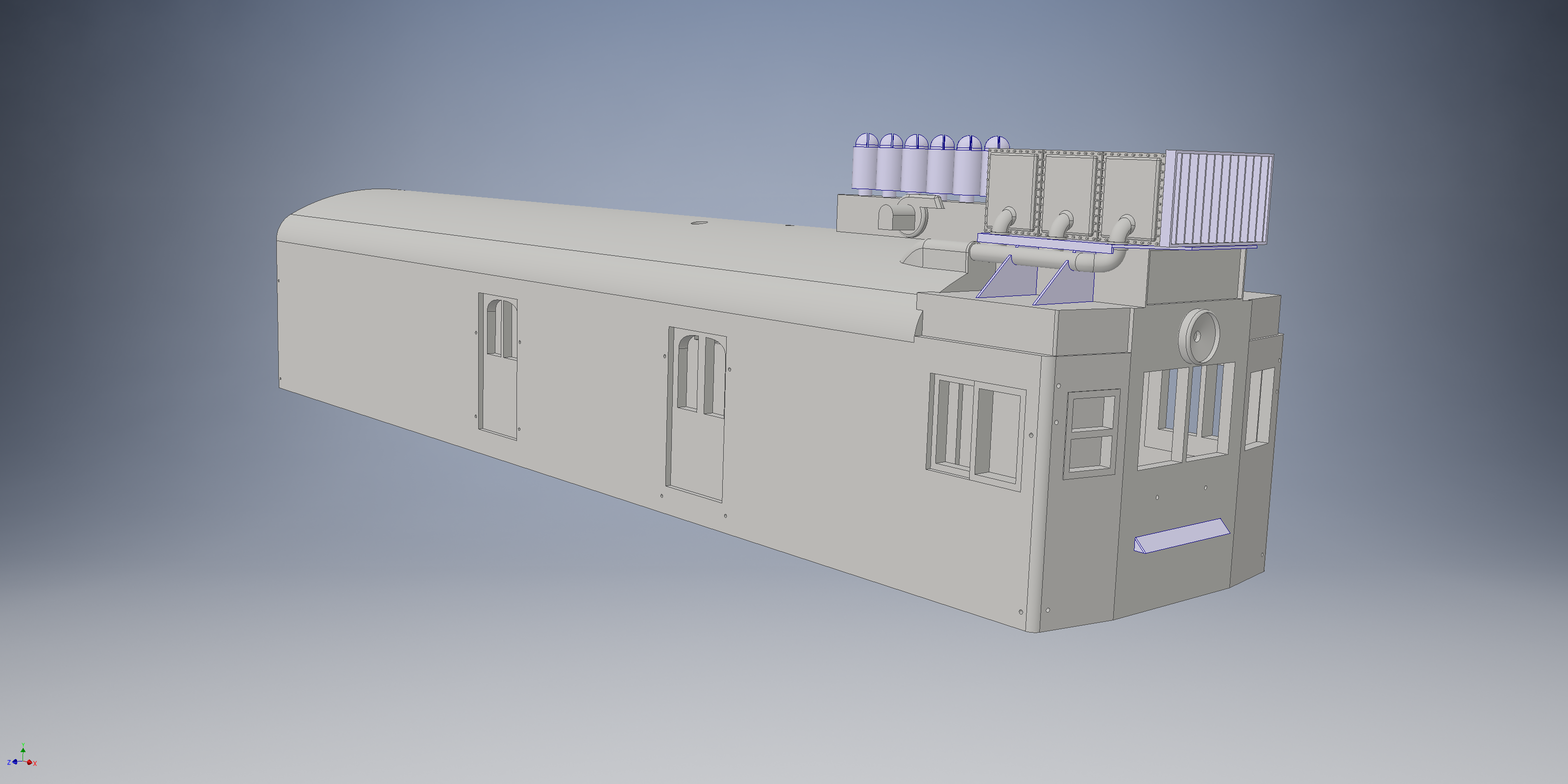

Found a copy I could access without being home.
If you're interested, I have the main body drawn in 3D but it's drawn without rivets because Shapeways was the best option when I did it.
When I get home I could look at where I left off on the drawing.  I think I had got a bit hung up on the radiator section and all of the associated piping.
edit:
I'm at least this far -
« Last Edit: March 26, 2019, 10:52:28 PM by wcfn100 »

hi Jason  would you be willing to share your 3d model.      I would love to try and print it on my photon printer.    And try to develop the radiator section and associated plumbing on the top.   If All goes well Ill send you a finished shell and  also one for Tom.    I have been looking to get back into modeling the great weedy for a while and this will give me some motivation. I am going to go through my slide collection, video and books to see if I can get some roof top views.

« Reply #5 on: April 04, 2019, 03:15:57 PM »
I don't mind sharing it, but I need to take a look at it and see what I did expecting to print it through Shapeways.  I think some of the doors are separate inserts that could print without the support fuzz.

Thank you Jason for your willingness to share the file.   The printer that I am using does not produce any fuzz.  So that would not be an issue.   I have some good pictures of the radiator sections of the front / left and right sides  however I have no pictures of the top view of the radiator section.   Any idea of what it would look like.  Was it a solid panel or was there openings for the cooling coils,   fans etc.     As soon as I figure out how to post pictures  ill put  up a couple of sketches.
I'm in the same boat.  Usually when I run out of resources, I check out the brass train market and see what they've done in the past.  I'd probably model the top the same as the front and rear with the coils.
Like this -
If someone finds a definitive shot showing some sort of cover, it'd be easy to add that later too even a completed model

So here's what I think is as far as I got.
All the doors and windows are separate inserts and the radiator section is several pieces.  Not sure if it would print like this.
