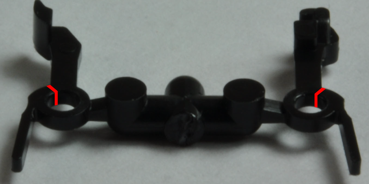

« Reply #2 on: November 19, 2018, 12:44:47 PM »
If you don't mind being a guinea pig, something that works for the welded coupler modification is to slice the ring right next to the shank.
For the welded coupler, I only have to slice the left part because there is no centering.
I tested the above modification to make sure everything stay together enough in the coupler box.  It seems to work and does loosen everything up which will provide a softer couple.
Bill H
  • Posts: 820
  • Respect: +178
Re: TSC coupling improvements?
« Reply #3 on: November 23, 2018, 05:17:51 PM »
Hi Jason:
I'll give it a try...
Cheers,
Bill
Bill H
  • Posts: 820
  • Respect: +178
« Reply #4 on: November 25, 2018, 02:29:21 PM »
Jason:
Tried your modification with both the short shank and long shank versions and it did improve the coupling almost.... As others noted, the long shank has a bit more flex and seems to work better, but I am really not interested in moving all my coupler box holes back to get close coupling.
And frankly, I realize that reasonably soft coupling was not the design criteria for the TSC, so I guess I was hoping against logic as I am not exactly a fan of slinky.
Nonetheless, I am surprised as to how little swing either coupler has in the coupler box. I was seeing some cars lifting off the track in a FT pattern #5 crossover due to a lack of swing in the coupler.
With reality setting in, I guess I will have to look elsewhere. TSC seem to be fine for operating within their design criteria, but not for my use in operations. Hello Bowser Bucklers?
Kind regards,
Bill
