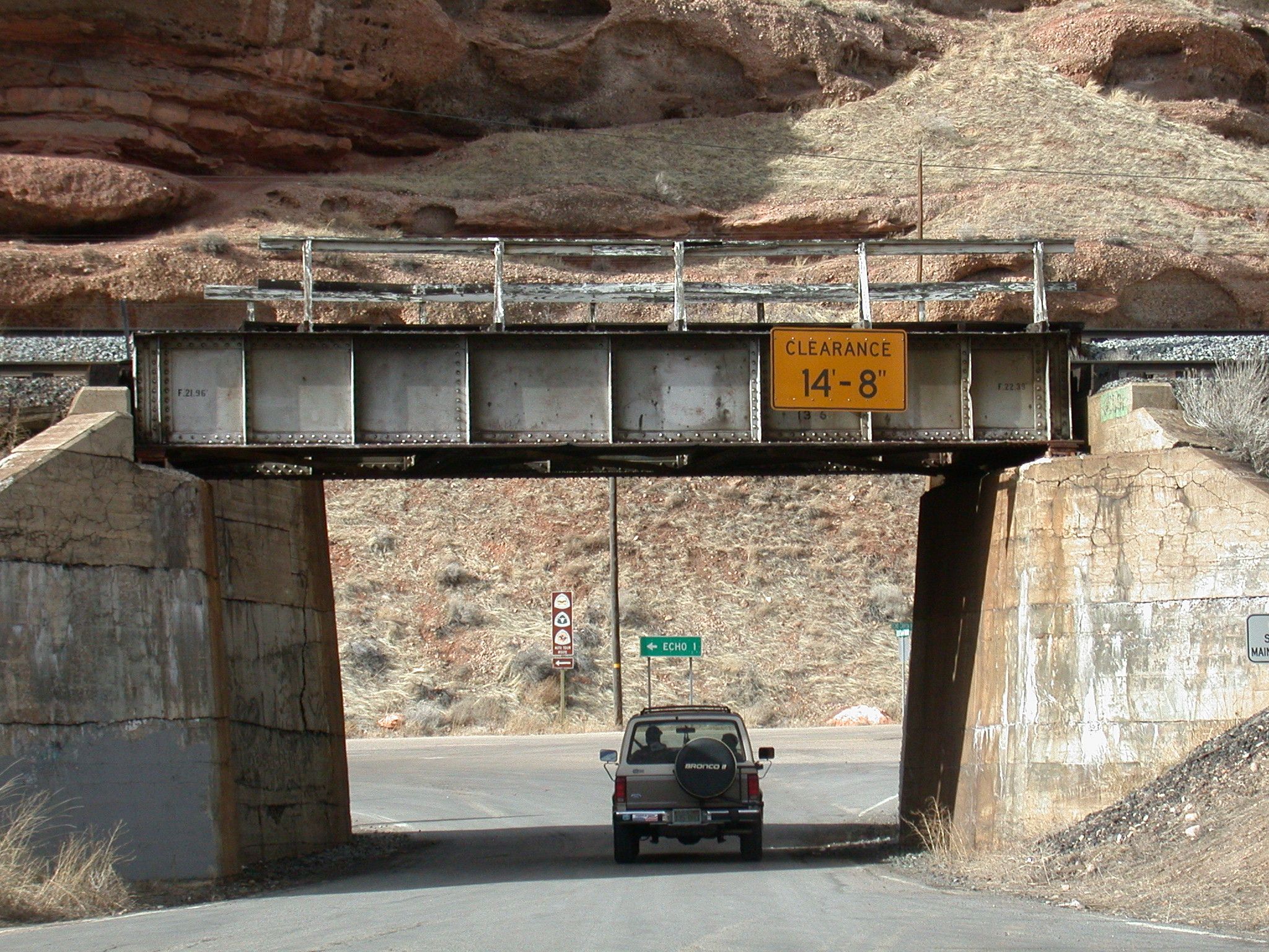

Photo (4) - Here's mo' felt grass in Echo Canyon on old construction when I was installing my Lincoln Highway underpass at Echo.  The grass looks good.  The bridge abutments need to get finished:
Photo (5) - Lastly, here's a photo of the Lincoln Highway underpass, with a bit of real grass to be seen as a comparison between real, and model:
