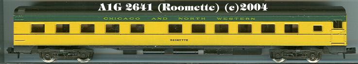

Buffalo Rapids (it's ACF, btw, not ACL builder) is better represented by the Atlas/Rivarossi version
http://www.spookshow.net/passenger/rivsmooth.html
http://www.irwinsjournal.com/a1g/a1g_2641.jpg
because it exactly duplicates the offset Corridor side windows arrangement, including the larger porter's room window on one side and none on the other. Maybe a ACF roof from a KATO car would look better than the stock  Atlas roof, but if you're a REAL rivet counter figure out how to add those metal seams and rivets shown!

I plan to use the Atlas/Rivarossi car and add rivets to make it look more like the prototype cars, for Blue or Buffalo Rapids.

...but if you're a REAL rivet counter figure out how to add those metal seams and rivets shown!
Easy (to answer, not to do) Bare Metal Foil for the battens and Archer Surface Transfers for the rivets.
