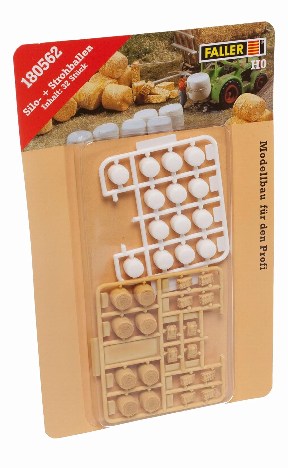

Faller has them. Maybe not the best looking ones but a good starting point.
http://www.ajckids.com/products/Faller/272562
Here is a picture what you get (Picture shows HO but number 272562 is, according to the Faller Website, the same in N)

I'd think some round or square Evergreen shapes rolled in some long static grass fibers arranged somewhat parallel to eachother might be effective? Bands could be made from fine wire in the Jewelery aisle at the craft store. Possibly even start with the Faller bales and roll them in grass?
