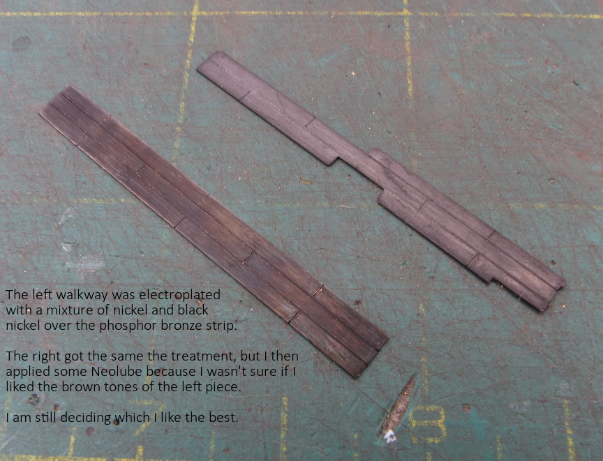

I feel like a lot of you, that it would probably be blacker than that.  I'm going to give it a hit of Neolube, which will blacken it up without losing the details and grain I got in there.

Thanks!  I really liked the look of it, but I was swayed by my deep-seated suspicion that they all look mostly black.
So I put some Neolube on them.  They look good, but they do not have that "amazing" wood look anymore.
I will post new photos in a day or so when I'm ready, and we can all debate.  I can get the Neolube off.  Just brushing it with alcohol and paper towels will take it off.  And since the underlying finish wasn't paint, but electroplating, it will be unharmed.
So I'll do the second running board without the Neolube and post some photos of both of them together.

Okay folks, here's the comparison.  Let's hear it!

Darker one looks like it's being used. Light one is a loco on static display.   :D

Left one!  More "weathered".

Yes the left one is too brown. The right one looks a bit shiny. But that is maybe only the lihting in the pic. I would try a chalk/powder treatment (black and gray tones). But it all depends on how much weathering you will apply overall.
EDIT: Now looking again using my PC, instead of the mobile, I withdraw may statement about the sheen. That must have been due to the picture rendering on my phone. But I still think both walkways need more black or gray.
