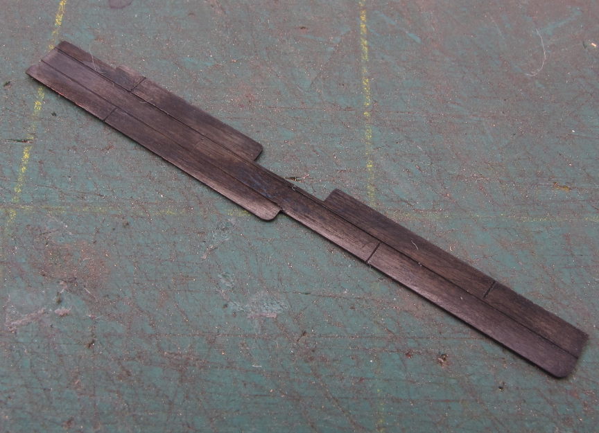

Well, I hear what you're saying about these things being black.  I would expect they were treated with a preservative that was mostly black, and yes, then they got rained on my cinders, soot, smoke and more "black".
Well, here's the experiment I tried today.
I made a walkway from .012" phosphor bronze strip.  Then I electroplated it with a mix of nickel and black nickel plating, being deliberately not too fussy about making it even as I swabbed over it with the solution and even dipped it a few times.
This is the result.  Maybe you'll say it should be blacker, but it sure looks like wood to me.
The board joints were made with an Xacto blade.  The wood grain was just 150 grit sandpaper swiped randomly over it a number of times.
I wanted to show you a photo, but Photobucket nailed me and said I have to update my account to enable 3rd party hosting.  So the game's over.

Yes, sure looks like wood!

Sure looks like wood, but I really think these were probably painted along with the locomotives.

Either painted black with the locomotive or coated with creosote making them almost black. But that really does look like wood.
