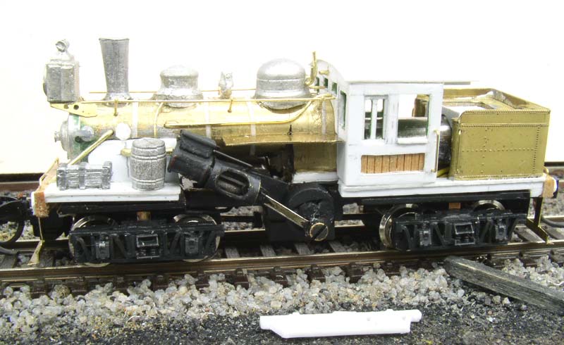

  • Posts: 3287
  • Respect: +3010
Re: Met Randgust at N Scale Weekend
« Reply #21 on: September 05, 2016, 07:57:57 AM »
Here's the construction thread text from 2005, when I built it.  The photo links died when my original ISP did.
And as I've told everybody, just in case the Egyptians are right, I'm taking this one with me.   It still ranks as the all-time most difficult build that I'll never repeat and will not do as a kit, period.  Its way too expensive with too many purchased parts to be viable as a kit, and at least on my version, uses a lot of highly obsolete parts from old Roco production.
http://forum.atlasrr.com/forum/topic.asp?ARCHIVE=true&TOPIC_ID=24154
What it did do, is make me try resin casting for the truck sideframes, with Chris333's help.  That's what started ALL my resin kits, in 2006.   Every resin kit I make traces itself back to this project.

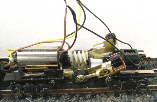

I've encouraged others to do this, and maybe five have actually done it.  What you need to see is this picture on how the mechanism is laid out, once you see this, you can pretty well get the idea of the entire design:
Tank is etched brass from RLW, and a lot of cast metal parts.  Cab is scratchbuilt styrene.   I had it running at Altoona, and it still runs very, very well.
My favorite 'cheat' on this project (other than the dummy jackshaft) is the piston rods.   They don't move, though they look like they do.  They are behind the crosshead, which just flops around in there. But with the crosshead moving back in front of them, you assume the piston rod is moving with it.  It's just a tiny piece of wire painted silver.
