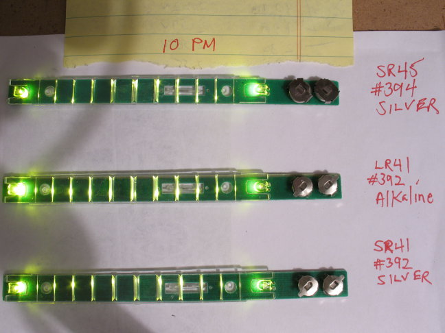

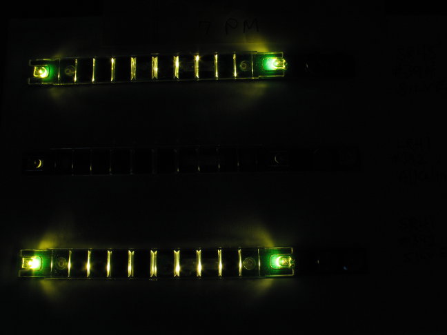

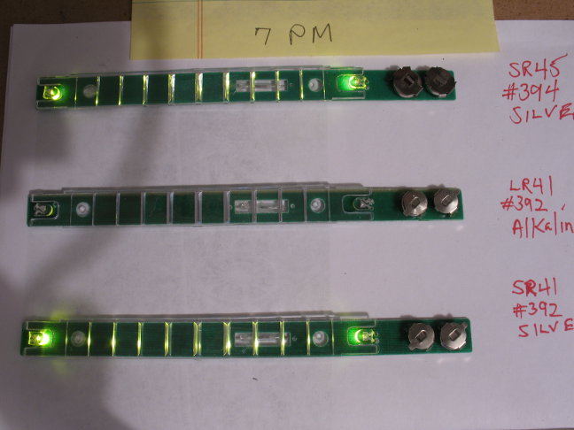

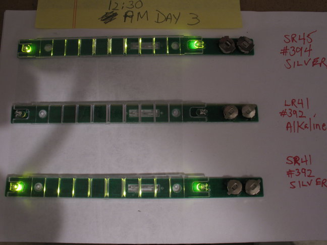

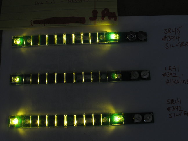

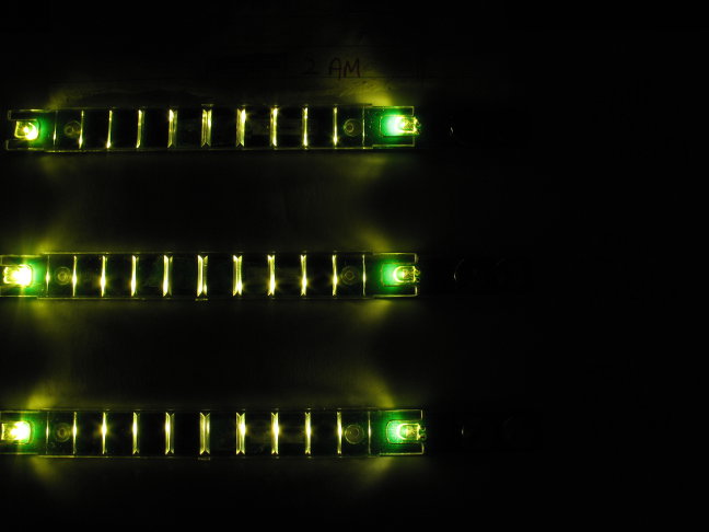

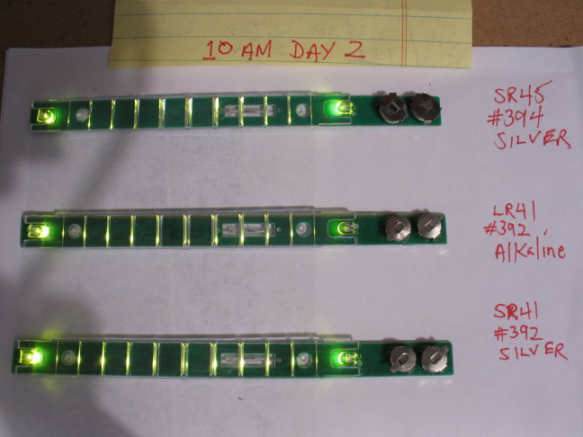

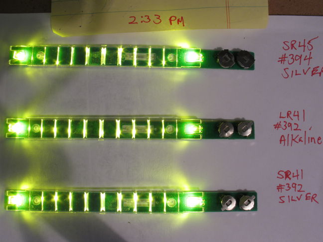

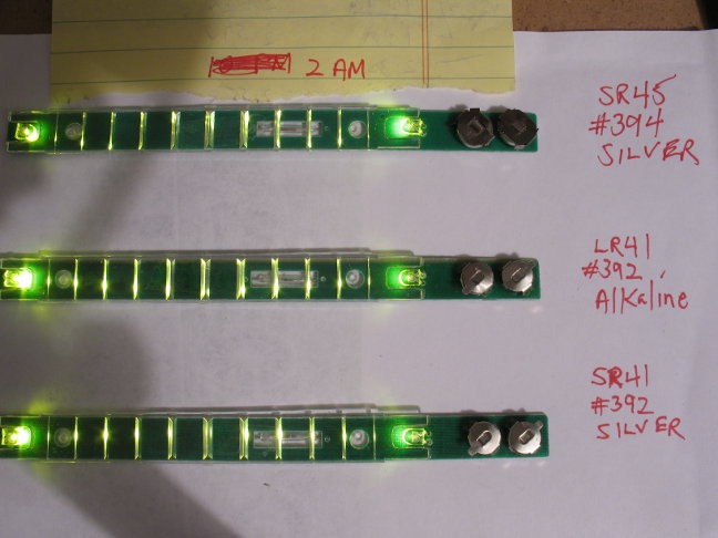

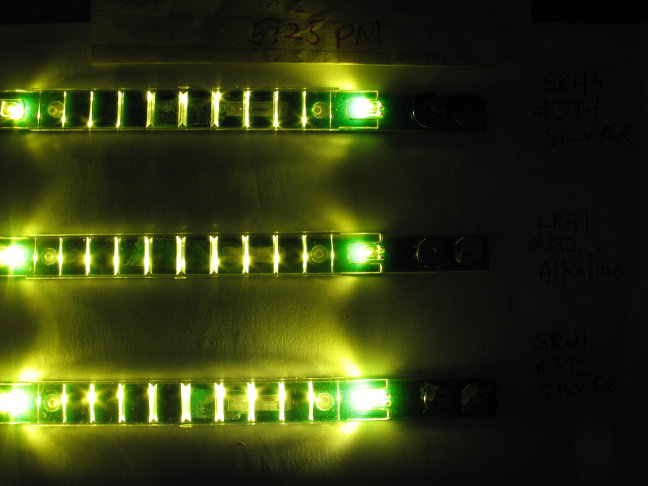

Here is a series of photos showing a head-to-head test of 3 battery types in stock Easy Peasy
boards.
We have
LR41 (alkaline, these are the stock type that are shipped with the car)
SR41 (silver oxide, exactly the same size, fit right in, but are expected to provide longer life)
SR45 (silver oxide, a larger diameter battery which can be made to fit into the existing holders
with a little solder-loosening and rebending of the holders)
As I expected, the SR41 and 45 lasted a lot longer than the LR41.  What surprised me
is that the SR45 really did not last any longer than the SR41, even though its mAh rating is a good 50%
higher.
I judged the life based on how bright the LEDs seem to hold up.  I admit, this is a little subjective,
so you can judge for yourself from the series of photos.
LR41  about 22 hrs
SR41 and SR45  about 32 hrs
Still to come, a head-to-head using the replacement golden white LEDs, which use quite a bit
less current, even with no brightness-reducing resistor, on these boards.
So, for somebody who uses them maybe an hour a week, you need a batter change about
every 8 months (vs 5-1/2 months with the stock battery).   If you run them at a train show
for 8 hrs a day, they'll be dead in 2-3 days.   I suppose their convenience, steady light, and
immunity to dirty wheels is enough of a pay-off depending on how much you use them.
Times are noted as hh:mm, the total hours and minutes of run-time.
00:00
03:00
07:30
11:30
11:30 (night view)
19:30
24:30  At this point, I call the LR41 "dead" because the light output has dropped off so much.
Giving it the benefit of the doubt, since I don't know exactly where between 19:30 and 24:30 it dropped
off, I'll call it 22:00.
28:30 (LR41 is now totally dead)
28:30 night view
34:00
This is a little subjective, but at 34 hrs, even though these are putting out some usable light,
I think it has faded enough that I would be changing the batteries, I'll call it 32 hrs.
« Last Edit: July 02, 2017, 04:31:28 AM by mmagliaro »
