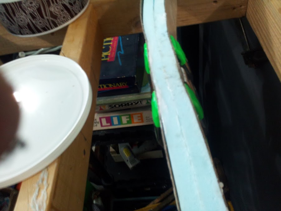

I'll be direct...I got the spline to break. I had photos of the actual moment of failure, but then accidentally deleted the pictures when I went to download them to the computer (stupid buttons!) I took another set of pictures of the aftermath and this time I managed not to delete them. It helps if you actually look at the screen BEFORE you click the mouse! Anyway, I went into the garage tonight for some reason that I can no  longer recall. I noticed that A- The roadbed still had a undamaged section and B- The glue had dried completely. That should make every question the validity of the last experiment. The glue was still wet. Probably needs a full 24 hours when used to laminate structural components  ;) Of course, I just had to try the fiasco again so I set everything up on supports spaced 2' apart. I set the 2x4 on the middle of the span and placed the bucket. At that point it was about 30-35 pounds. Everything looked great and I took some lovely snapshots. I went for 70 pounds and had my camera focused on the spline. It didn't instantly fail, it took several seconds, but it did break. I was so busy with the camera I didn't catch the bucket. Below are photos of the aftermath.
The scene of the disaster...
Shards of roadbed....
70 pounds of hardware at the bottom of the abyss...
