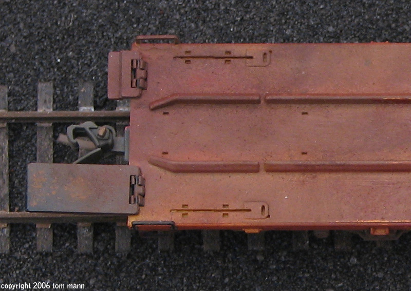

Here's mine:
I lightly airbrushed the ryourstone formula of 2 parts rust to 1 part grimy black to create a grayish/green grunge base coat.  On top of this, I airbrushed a boxcar red/oxide red mixture.  I followed up by drybrushing acrylics with a deer hoof brush, mixing in a little chalk here and there.
The Krunk.org site is great for trailers/flatcar shots.
