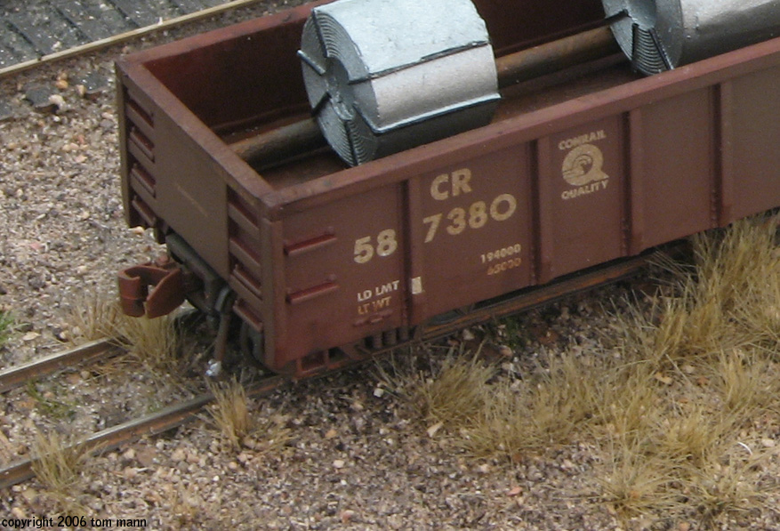

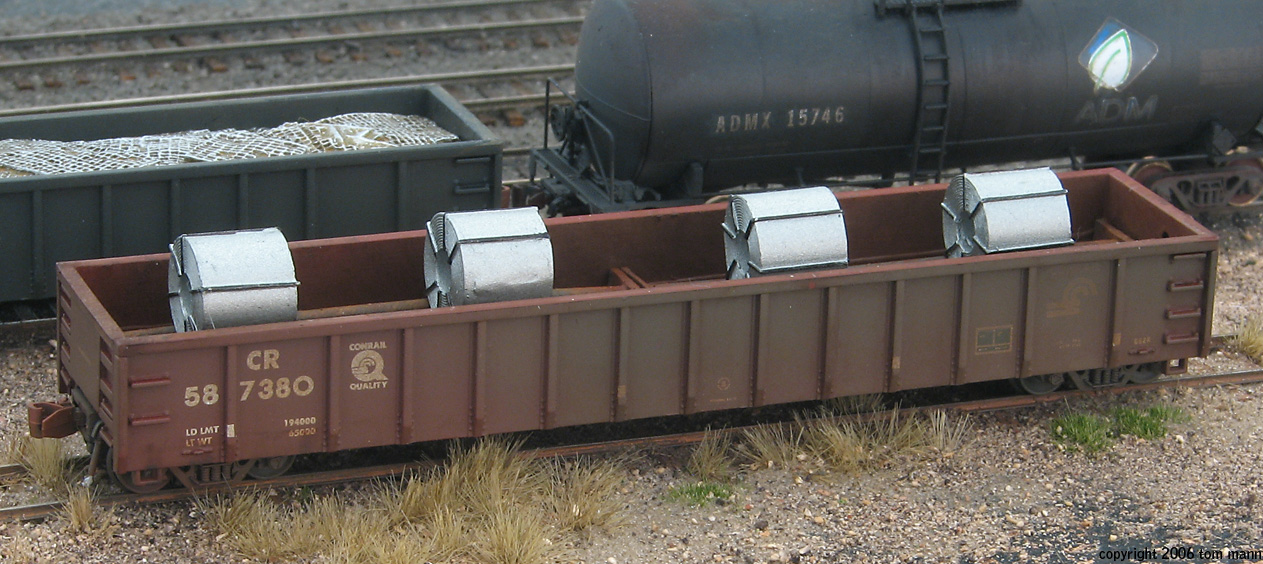

Taking close-up photos is a great learning tool.  Seeing modeling up close trains the eye to spot what looks good and bad from normal viewing.  When I felt pretty good about my weathering, I moved on to track.  Now, I'm on ground cover.
Two things bothered me about ground cover:  Texture and color.  The texture of foam based products looks ok as a flat surface, but as modelers, we tend to use ground foam for small bushes and shrubs and tufts of grass because of a lack of anything better.  Fine from a distance, but not too great close up.  Colors are mostly too green and vibrant, too.  In real life, colors take on a more muted appearance, especially summer and fall grass colors.
I decided to try this product called Silflor, available from scenicexpress.com.  These look like what they're supposed to be (tufts of grass) as opposed to merely an approximation of what they represent (like a pile of groundfoam masquerading as grass).
To install, you pull them off of backing and glue them down.
The dirt is a mixture of Highball dirt and Highball brown ballast.  I dusted the track with Polyscale 'dirt' to tone everything down.  My goal was to match some photos I have of unkept MILW trackage.
The Silflor products are expensive, but judicious use in some scenes or the front of your layout will keep the costs managable.  Scenic express has a ton of great looking "premium" landscaping products, including some Heki products which look like Silflor knock-offs.
Comments? Let's do trees, next :)

Sweet.
I saw another guy's album on railimages who used this stuff for gras patches beside the tracks, between ties, along edges of buildings a open spaces. It looked awesome, especially next to handlaid HO track.

DAMN, that stuff looks nice.
Too bad Athearn kinda botched that gon. The lowest numbered CR coil gon I've seen is 600465. And I've only seen one CR gon that the old MDC gon approximates actually in coil service, 608765. But you can always just pull the load and use it in another car, so it's not a huge error.

« Reply #4 on: February 13, 2006, 11:38:55 PM »
Yeah, removing the loads is really easy too. Just look at the car funny and it'll fall out.
They're not really attached by anything at all.

I just bought some Silflor tuft's  a few weeks ago. They are great! I got some 4mm and some 2mm, I need to get the brownish color that Tom used here though. I think you get a nice amount for the money and even though it is pricey I didn't feel "ripped off".
These are probably the railimages photos that were mentioned:
http://www.railimages.com/albums/jeffkraker/anh.jpg
http://www.railimages.com/albums/jeffkraker/ang.jpg
They have a sticky bottom, but like Tom I glued mine down just in case. They are soft enough that you could maybe run trains over grass between the rails with no problem.
Yeah, Conrail's coil-assigned gons were in the 6xxxxx series, 5xxxxx were regular mill gons for every other service. But most model manfucturers _especially_ MDC don't know anything about specific commodity assignments for various car series, and usually don't bother to check/research either.
