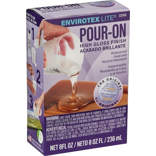

Dwight, what "epoxy product" did you use for your water the second time?
Oh man, I just KNEW someone was going to ask that, and I’m afraid that I no longer remember.
It was a competitive, 2-part product offered by my LHS.  Worked flawlessly, applied over painted styrofoam, with no outgassing bubbles over the last 15 years.
  • Posts: 35464
  • Respect: +6707
Re: Base coat color for river bottom
« Reply #12 on: October 28, 2025, 11:31:07 AM »
Most common in hobby and craft stores is Envirotex.
But there are many other similar 2-part epoxy products out there.  They all should work well.
